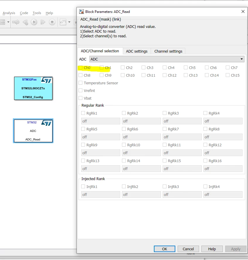

I've setup the pin configuration for my device using STM32CubeMX and setup the STM32 MAT / TARGET environment in Simulink along with the necessary add-ons e.g. embedded code generation and MatLab code generation.
Now when trying to build a simulation GPIO blocks work as expected although ADC blocks have no channels available.
Has anyone run into this issue before and have a possible solution? I've also tried Matlab 2021a with latest STM32CubeMX and run into the same issue.
