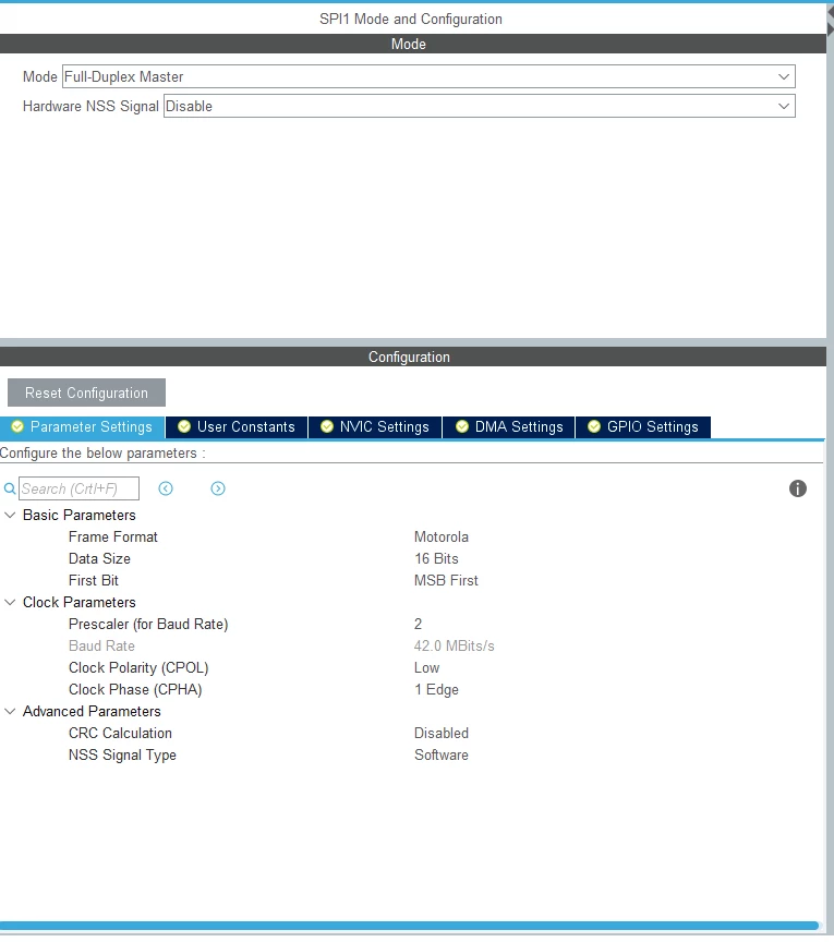

I want to control the ad9833 module with the stm32f4 development board. I have a library but I couldn't get SPI communication. I cannot get any wave output from the module. I cannot adjust frequency. where can the problem be? I need to create this project with CUBEMX and do the work using the Keil development environment. I am using the SPI1 module of the board. I use PA5 pin as SCK, PA7 pin as MOSI and PB2 pin as GPIO reset. Below is the code part that i tried to spi communication.

Thank you for your answer. I set CUBEMX SPIsettings as attached. When I want to change the frequency, I send data like the code below.

Tesla DeLorean
Guru
May 29, 2020 3:23 AM UTC
You're not using SPI1, configure the pins in a GPIO mode, and sequence them per the data sheet​.
Review signals with a scope or analyzer.​
