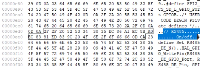

Hello.
I am a stm32cubeIDE user in Korea.
Thank you for creating useful software.
I processed "Generate Code" in the MX.
It changed the code of Korean comments.
I used the comment //.
Please don't change the characters between // ~~~~ 0x0D.
This is normal status.

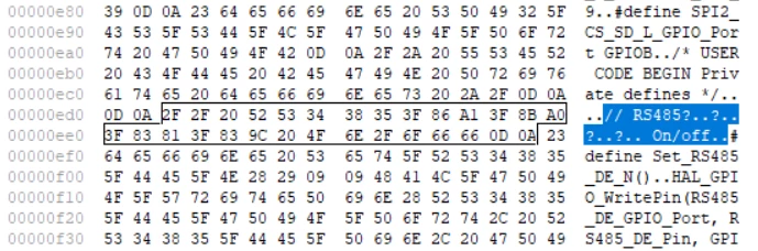

After code generation it changed to:
After that, I cannot read Korean.
I would like a quick fix.
Thank you.​

Mike_ST
January 22, 2020
Hello, thank you for reporting, ticket entered.
simkslv
Visitor II
May 7, 2021
I have same problem. Is it fixed?
