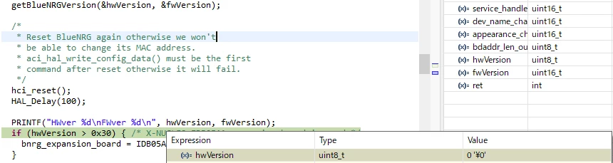

I can't get FW / HWVersion.
・Other boards seem to need to update the FW with flashUpdater.
⇒・Does B-L4S5I-IOT01A also need FW Update?
⇒hci_send_req was timing out.
I'm not using flashUpdater. Is it related?
⇒It just didn't generate the source correctly. (hci_ti_interface.c was not implemented)

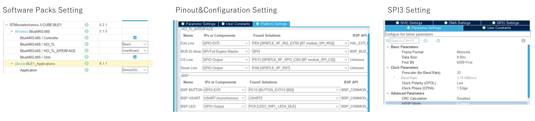

I configured it like the attached image.
When communicating with SPBTLE-RF module using SPI3 with B-L4S5I-IOT01A, is this image correct?
Regard.​

Dear sir
solved.
I set the attached image.
I confirmed that BLE works with B-L4S5I-IOT01A.
Thank you for the information.
