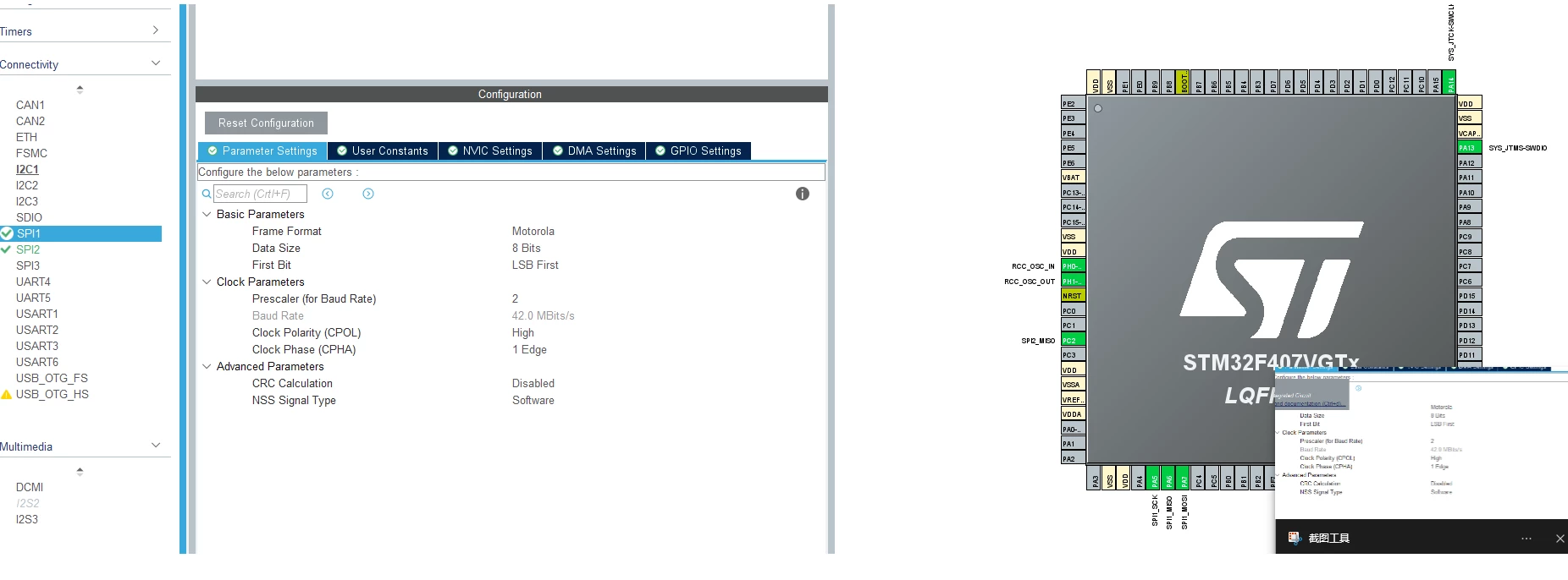

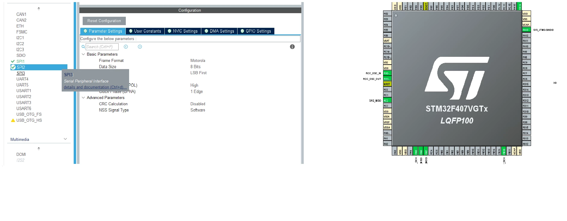

A stm32 chip configuration master-slave mode test encountered a problem!
I'm using a SPI1 as a master, SPI2 as a slave, SPI1 provides the clock to SPI2, SPI2 uses the SPI1 clock reference, and when I use __HAL_SPI_ENABLE(&hspi1), the SPI1 clock line pulses, which is fine.but when I call
uint32_t tmp = 0x12345678;
HAL_SPI_Transmit(&hspi2,(uint8_t*)&tmp,4,100);
When using SPI2 to output data, the clock line of SPI1 does not output pulses. I did not turn off SPI1, and SPI2 did not output data. I checked the status register and found no flags. The hardware connection has been connected to SPI1 and SPI2. Excuse me How could something like this happen?0693W00000LyoUyQAJ.png0693W00000LyoUtQAJ.png

Yyang.5
Yyang.5Author
Apr 25, 2022 3:38 AM UTC
My idea is similar to yours, but my idea is to use SPI1 to generate a clock signal, and SPI2 also uses this clock signal to send data, not to receive data from SPI1, so SPI1 is used as the master and SPI2 is used as a slave, but I The problem is that when I use the send function of SPI2, SPI1 seems to be broken. SPI1 does not even output the clock signal. Of course, the premise is that the CLK of SPI1 and the slave CLK of SPI2 are connected together, and the CLK of SPI1 can also work normally before the program does not call the sending function of SPI2.
