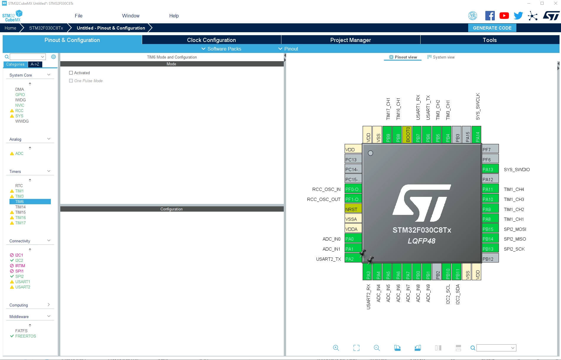

waclawek.jan
March 25, 2021
Attached one of the possible solutions.
I believe I could pull out the debug UART using SPI, although the good old bitbanging is an option too.
martincho
martinchoAuthor
March 25, 2021
Nice, thank you. I ended-up with a similar layout after playing with it some more. In my case I had to relocate UART2 in order not to lose SWCLK and SWDIO. That eliminated ADC2 and 3, which I replaced with 8 and 9.
I am going to try your configuration and see what it looks like. I would much rather all the A/D inputs together in the corner rather than have a UART in the middle of it all.
I neglected to add that I also need one set of inputs for a quadrature encoder. I don't think I can do this in hardware (could be wrong) given the intense use of timers. Being that this is for a low speed user interface knob, it would not be too difficult to implement in software. If all PWM generation is happening in hardware I'll have plenty of time for that.
Thanks.

waclawek.jan
March 25, 2021
> what's missing in your configuration are the SYS_SWCLK and SYS_SWDIO pins.
Sorry I overlooked that.
