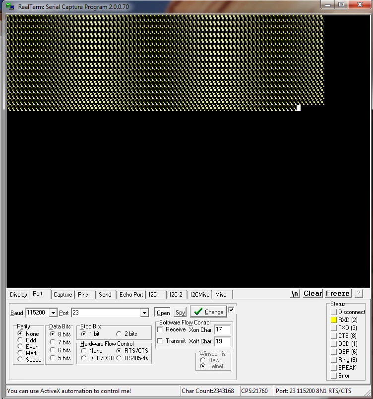

Thanks everyone for all the help! I managed to get my ADC values printed out. I still have a couple questions.
1) That are the letters to the right on the numbers? They seem to be related to my \t and \n commands to tab and print a new line in the UART code.0690X000006DEP7QAO.png
HAL_UART_Transmit(&huart2, (void *)str, sprintf(str, "%d\t", adcVal[0]), 10);
HAL_UART_Transmit(&huart2, (void *)str, sprintf(str, "%d\r\n", adcVal[1]), 10);
2) When I print my ADC values in the debug tab, they appear to be close but slightly different then the values printed over UART, why might this be? I put a delay in the uart print so I can compare them but really didn't think they would every be different. One thing I need to check is that I'm reading ADC2_IN14 on PC4 and ADC_IN15 on PC5, which I think correspond the picture below. I know I initialized them correctly in CubeMX but not 100% sure I'm using them correctly.

Tesla DeLorean
Guru
Jan 24, 2019 6:38 PM UTC
>> why might this be?
Because the values in the arrays are changing in the background faster than you can print them?
Copy the instantaneous values to a secondary buffer, and print those to the console/debugger.
With respect to the control characters in RealTerm, isn't that a checkbox item. Try selecting a different terminal font?
HT (Hard Tab), the ASCII 9 value
CR (Carriage Return)
LF (Line Feed)
