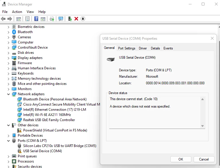

X-NUCLEO-LPM01A. window 11 and CubeMonPwr-Win 1.1.1. PC shows USB Serial Device cannot start (code 10).
I use X-NUCLEO-LPM01A. Window 11 and CubeMonPwr-Win 1.1.1.
When I plug in USB, PC shows USB Serial Device cannot start (code 10).
0693W00000aH6vGQAS.pngDo you have any solution for this? Thanks

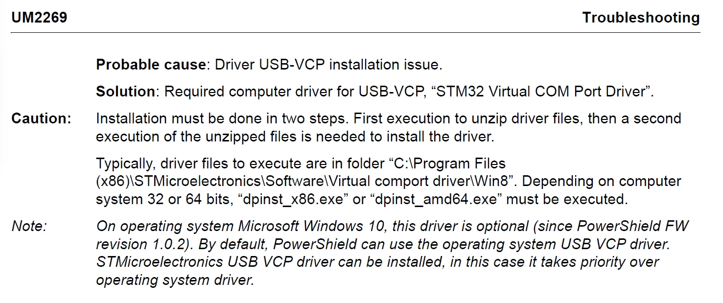

I think I have fixed this issue by reading UM2269.
Please close it. Thanks.
