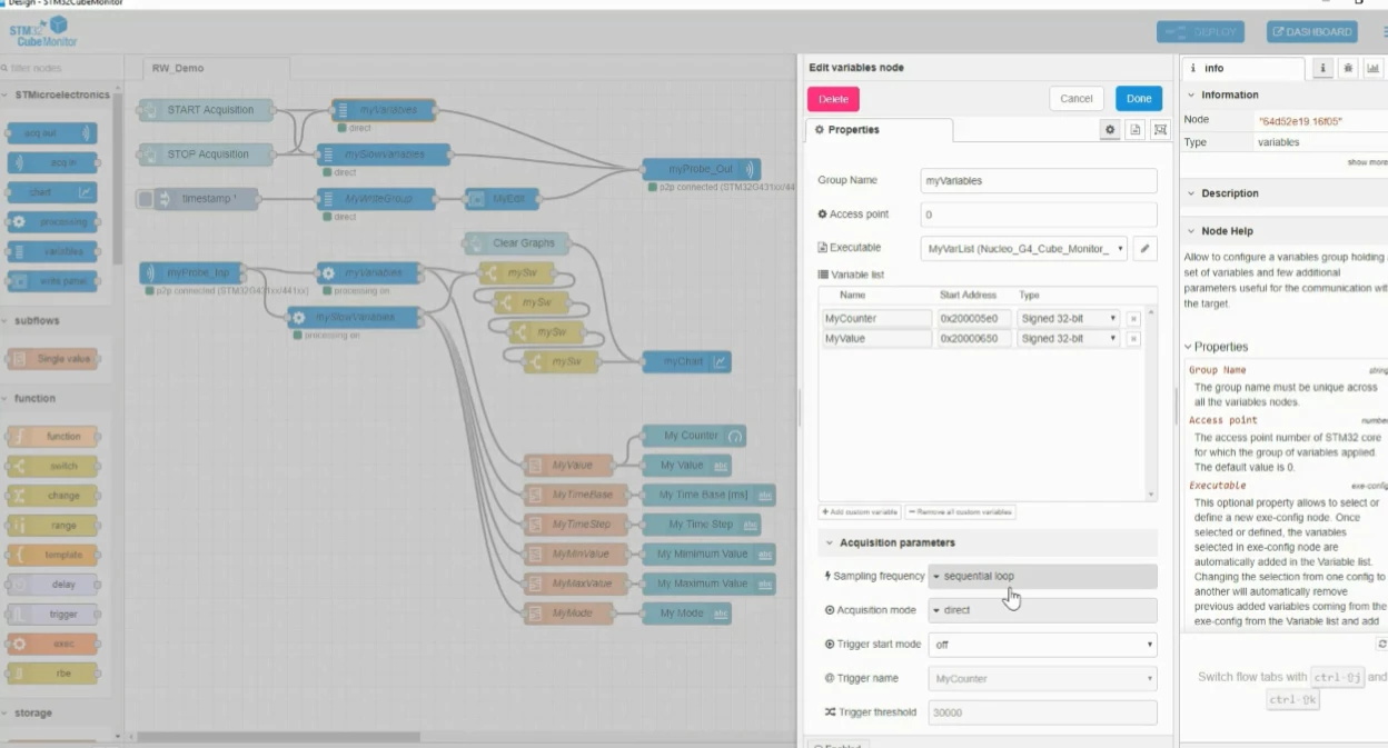

Hello
If you want to start with CubeMonitor, you can watch the "gettingStarted" video : https://www.youtube.com/watch?v=bTJhqHWniZE&feature=youtu.be
The flow is simple and based on the reference flow already included in the application (menu/import/Library/STM32CubeMonitor_BasicFlow.json)
For the application on the STM32, it is dependent of the board/STM32 that you are using. You can easily build a test binary : create a project for your board and add:
  • the variable declaration : "static volatile long counter;" (you can add many variables)
  • increase the counter in the main loop : counter++; (or do what you want)
Then, build the program, import the elf in STM32CubeMonitor as described in the video, and it is done.
Best regards
Stephane
