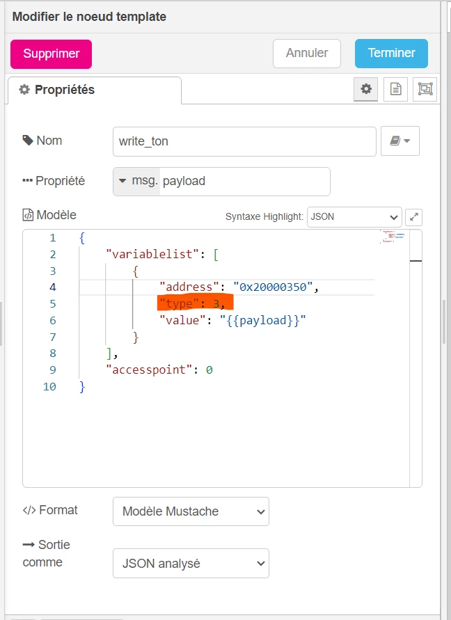

template node JSON part STM32CUBE MONITOR
Would it be possible to have the correspondence of the JSON type according to the type of variable we put? Please
I've been able to identify a few such as :
type 1 -> uint8_t
type 3 -> uint32_t
Best regards
    stephane.legargeant
    Oct 14, 2024 11:34 AM UTC
    Hello
    The information is available in the description of the "write panel" node. It is :
    • 1: Unsigned 8-bit
    • 2: Signed 8-bit
    • 3: Unsigned 16-bit
    • 4: Signed 16-bit
    • 5: Unsigned 32-bit
    • 6: Signed 32-bit
    • 9: Float
    • 10: Double
    In order to help other users, if this is answering your question, please mark it as answered. Thank you.
