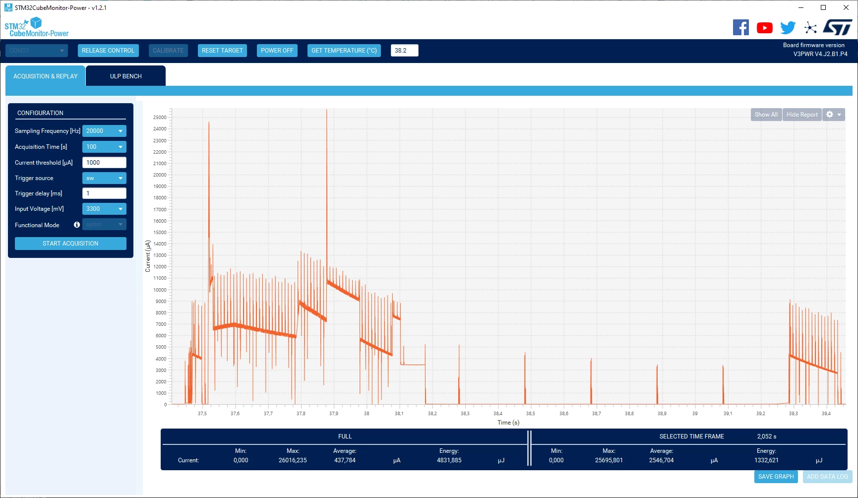

STM32CubeMonitor-Power Energy Values sometimes breaks with 1.2.1?
Something went wrong with the Energy Values in µJ yesterday.
If I am not mistaken, to go from µA to µJ should be voltage*current*seconds, so 2546µA average current for 2,052 seconds with 3,3V input voltage should be 17240µJ.
The monitor software said 1332,621µJ. I have no idea why.

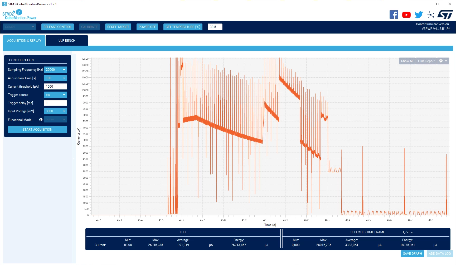

A similar measurement after restarting this morning looks ok again:

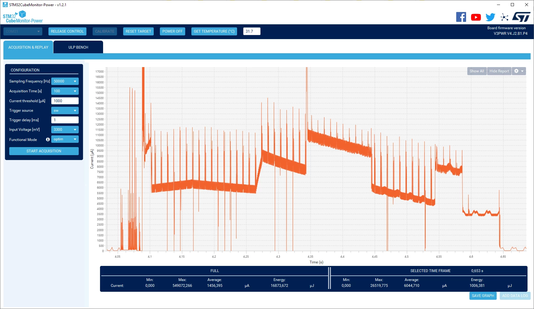

Edit: A few minutes later it's broken again and even reconnecting the power meter and restarting the software does not help to recover again

    Hi @OliM ,
    You are right it looks like something wrong with the way STM32CubeMonitor-Power calculates the energy based on the measurement.
    I will escalate this issue, please can you give me more information:
    -  Are you using the new STLINK-PWR ?
    - Can you confirm that your are using the version v1.2.1?

    OliM
    OliMAuthor
    Senior II
    Jul 11, 2023 8:34 AM UTC
    As you can see on the screenshots, I am using the  STLINK-V3PWR at firmware V4J2B1P4 with the monitor version v1.2.1 . It feels in the moment like only the first measurement of the day is computed correctly. I have some other tasks to do because of which I can not restart my PC right now, but I will also try that some time later.
    i have used the 1.1.x with the L5 disco with integrated power meter in the past and have not seen the issue there.

    OliM
    OliMAuthor
    Senior II
    Jul 11, 2023 10:55 AM UTC
    v1.1.1 seems to be stable (but of course missing the power on/off switch of 1.2.1)
