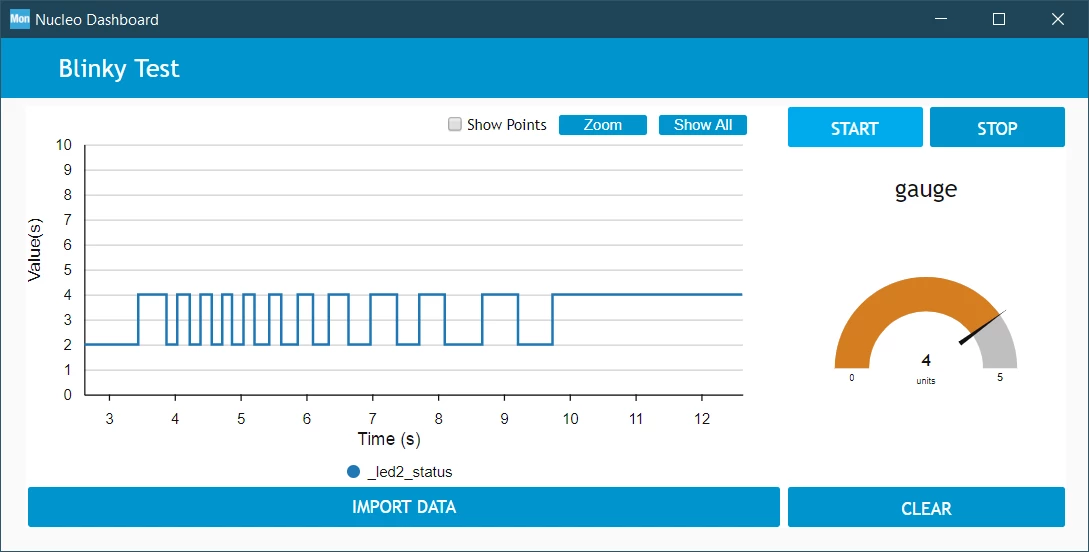

Made a simple "blinky monitor", and I'm impressed with the tool. I've previously used UART -> Serial plotter to plot my graphs. I will definitely use this tool in future projects.

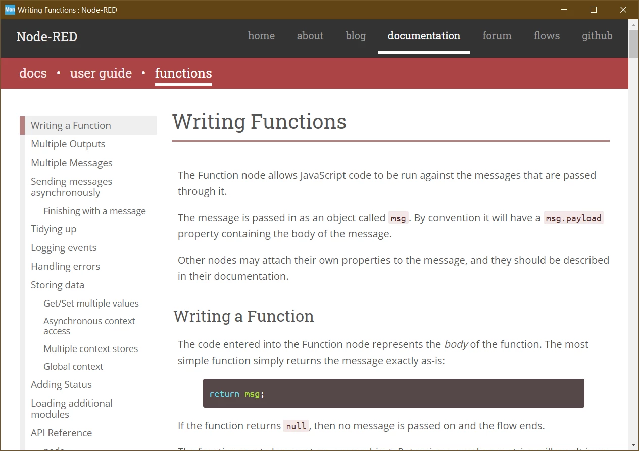

I may have come across a bug: I launched the documentation window by clicking on the "function" node => information => details => "online documentation" link. Whenever that's open, I am unable to launch the dashboard by clicking the "dashboard button.
stephane.legargeant
Mar 9, 2020 5:23 PM UTC
Hello AShri.1
You are right, when the online help is open, the dashboard should be displayed, but it is not.
I can suggest 2 workaround :
  • Close the help windows and then the dashboard will open.
  • Open the tool inside Chrome ( http://127.0.0.1:1880/), and you will be able to open help and dashboard at the same time.
Best regards
Stephane
