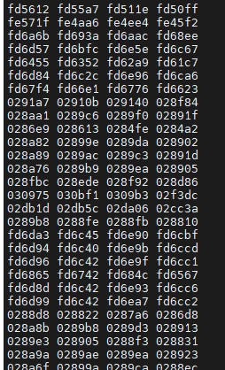

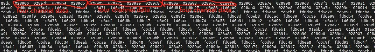

I am collecting external ADC data, and then inputting it through serial port. 24bits is one channel data, every four is a group(as figure shows). I want to chart the data for each channel, and have the four channels simultaneously do the waveform drawing in real time.
Do you have any relevant examples?

I've been watching javascript and node_red tutorials all afternoon, and I'm pretty new to the programming that functions require....so I'm still out of ideas. I changed the serial port input to the form shown in the figure below. The four values ​​in each line represent the data of four channels. Then I can use the chart to make dynamic waveforms. Can you be more detailed?

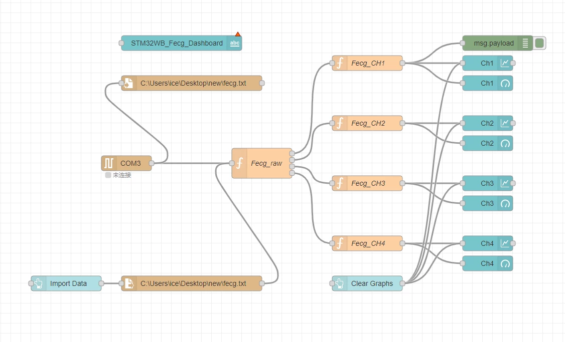

0693W00000UnubkQAB.pngAnd I have a new problem. I want to display dashboard in my phone, ipad and computer website. What should I do?
