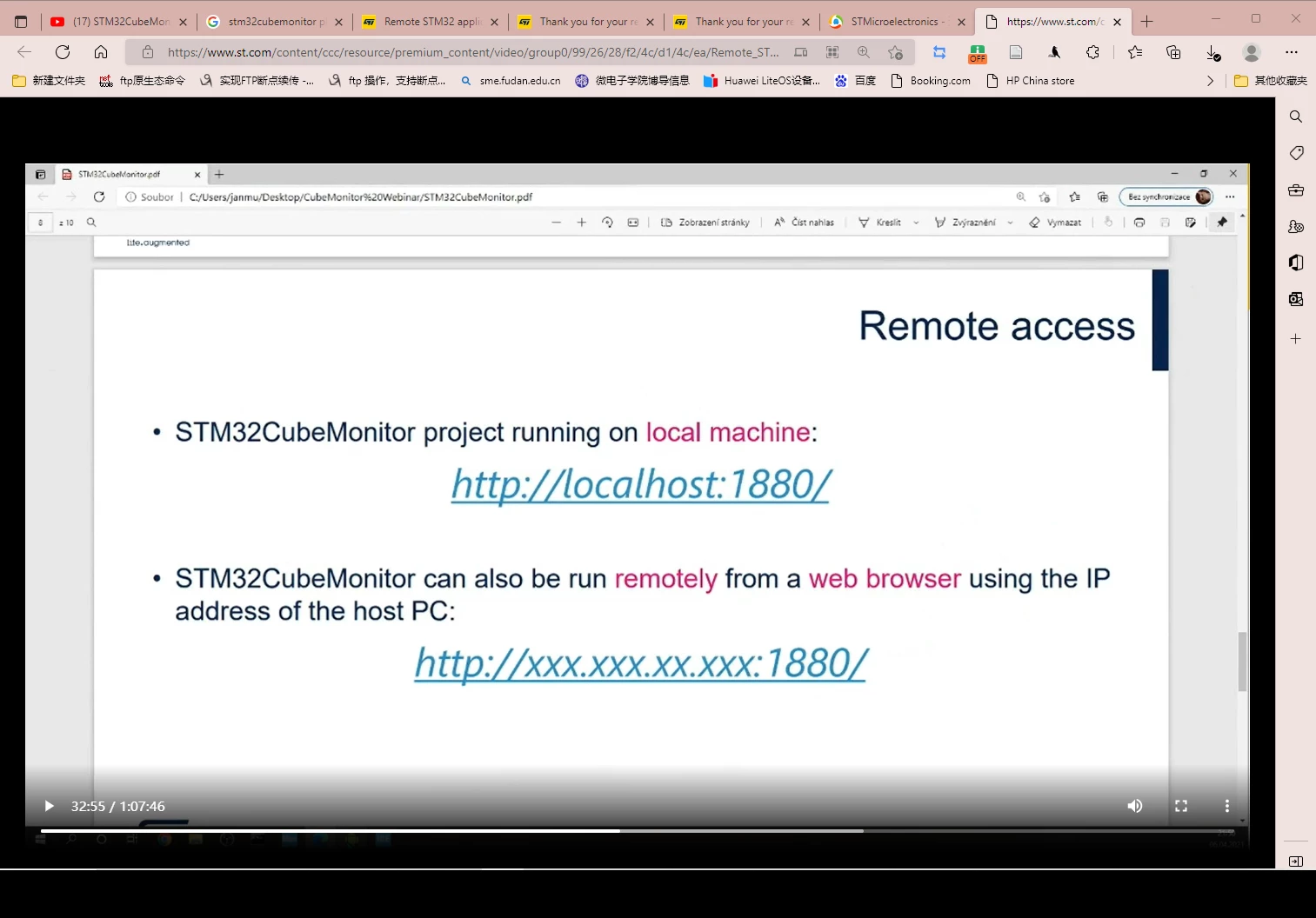

I want to use other computers, mobile phones and ipads for remote monitoring.
Another computer can ping the host successfully , but can't connect to Dashboard. My phone and ipad are the same.
What should I do?0693W00000UnxWyQAJ.png​

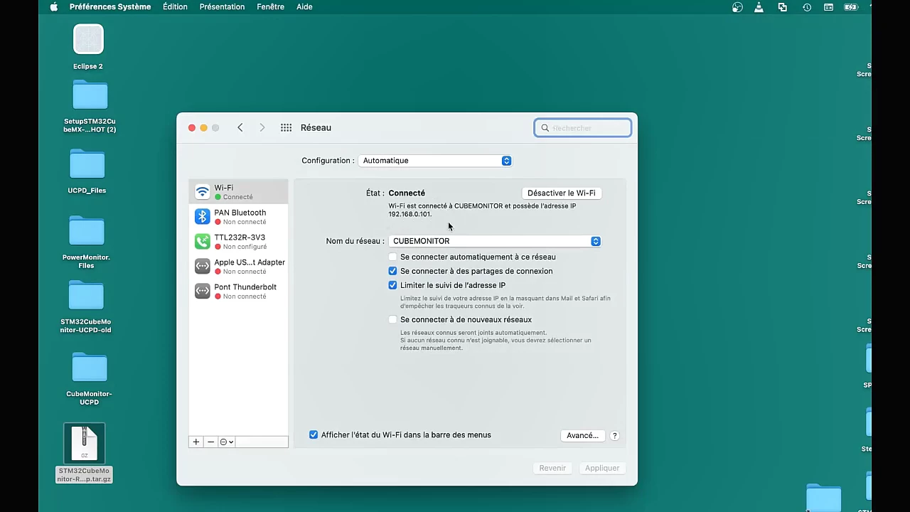

Hello
There is no special configuration in the picture, we just use it to see the IP address.
Some point to check :
  • Try to start a web browser on the host PC and open the http://localhost:1880/ and check that it is displayed
  • Check in the setting file: The line uiHost: "127.0.0.1" should be commented. If not it will restrict connection to local machine.
  • Check if there is no router or firewall between the devices which blocks the connection.

Is this address the host ip address or the router ip address?
stephane.legargeant
Oct 13, 2022 12:36 PM UTC
Hello
It is the address of the host computer. (The computer running STM32CubeMonitor)

I have watched this video many times before, and my understanding is that the host, mobile phone and ipad are in the same local area network. Even in the same local area network, other devices still cannot connect to the host address (ipv4), is there any configuration required for the router (but I can ping my computer with other computers, when I enter http://Ip address:1880/ , no dashboard found).:face_with_tears_of_joy:
Is there anything special about this configuration in the picture?

Hello
