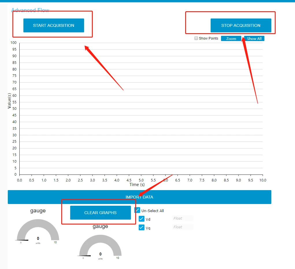

Dear all,
How to adjust the layout of dashboard components as a whole?
I now find that each component can only be individually sized and cannot be placed in a single panel to evaluate the layout as a whole.

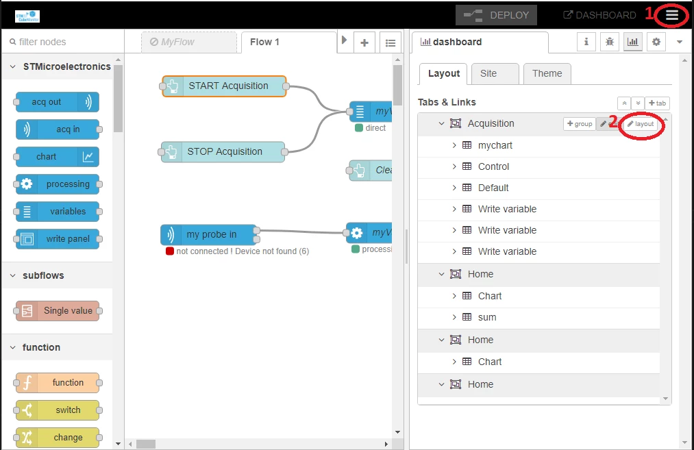

Hello Fhu.1,
In order to modify your layout:
1 you need to click on the burger menu, on top right side,

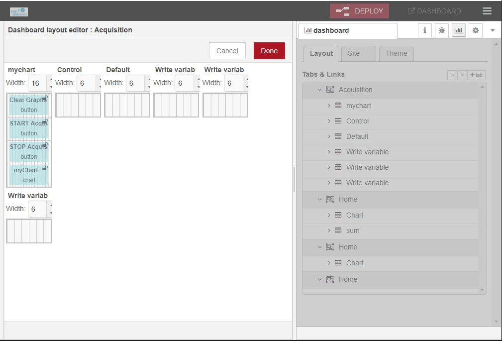

2 select layout of the group your buttons belongs to
Then you can move the elements the way you want
Hope it helps

Thank you very much for your answer, now my dashboard looks much more comfortable, ha ha!
Thank you!
