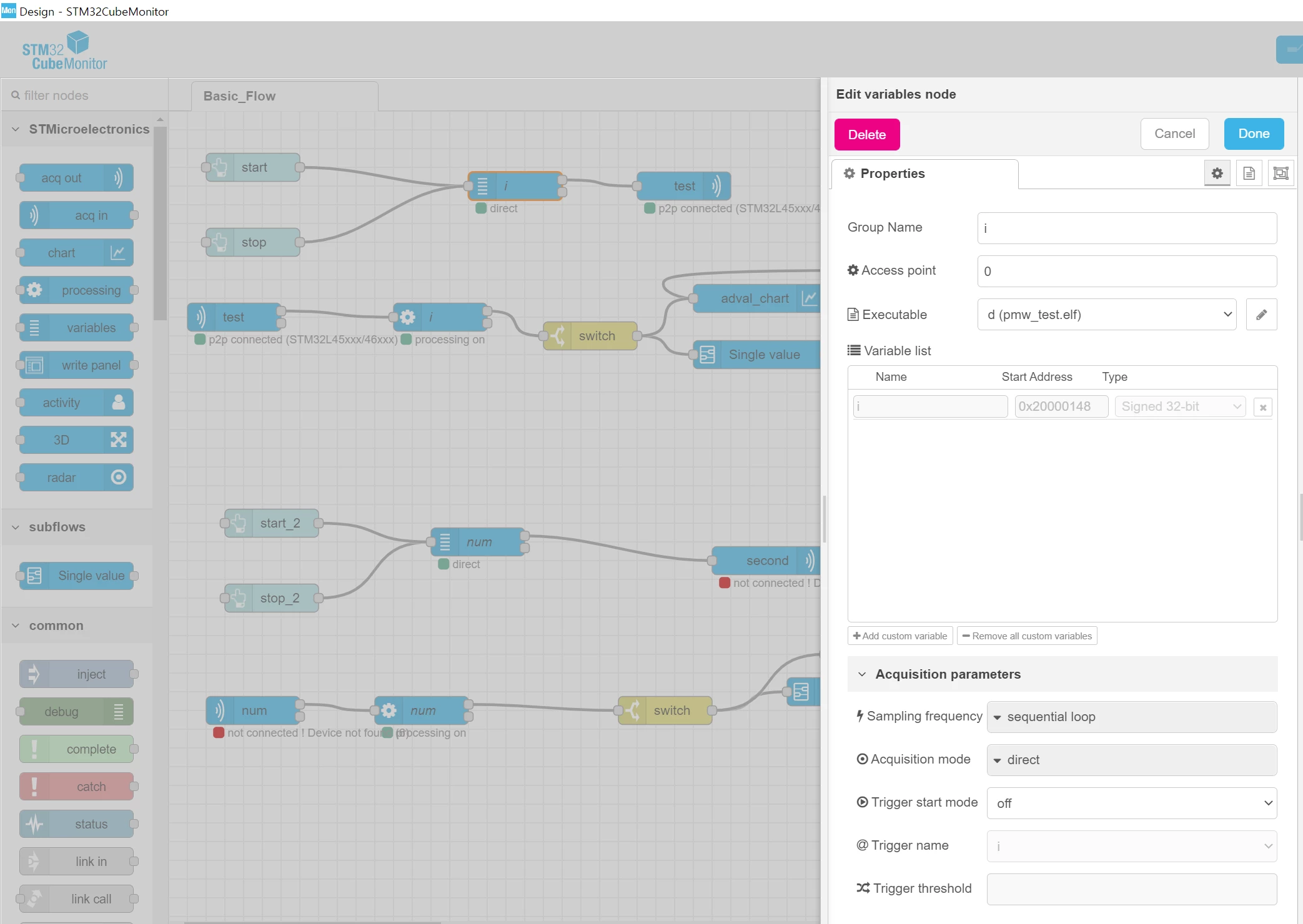

Can you make the time interval shorter?

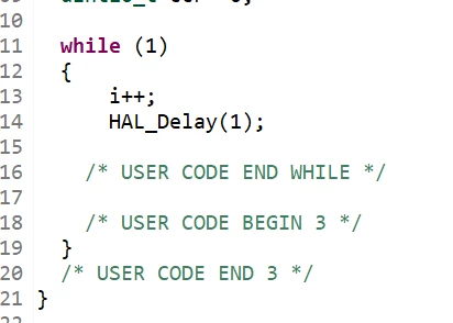

i increases by 1.  The delay is 1.

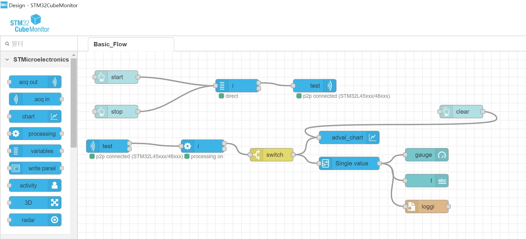

stm cubemonitor
kust_0-1694174685697.pngvariables node

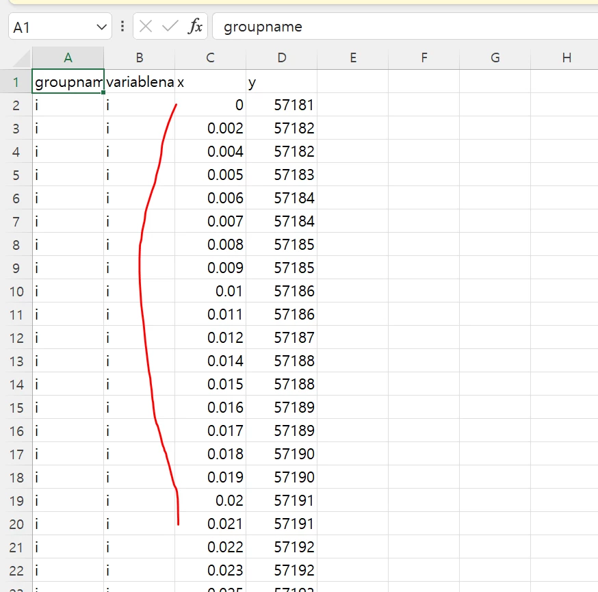

I received the data as an Excel file.
x is the time, and y is the value of i.
The time interval of the data is 1 ms(=0.001s).
If you can shorten the time interval, please tell me how to do it in detail. please.
thank you.

    Hello @kust
    The best way to make shorter interval of time is by using a TIMER in counter mode instead of delay and than you can configure the TIMER to count and Interrupt every ∆T you want (event in microseconds). To do this you can find exemples in all STM32cube firmwares.
    Best regards.
