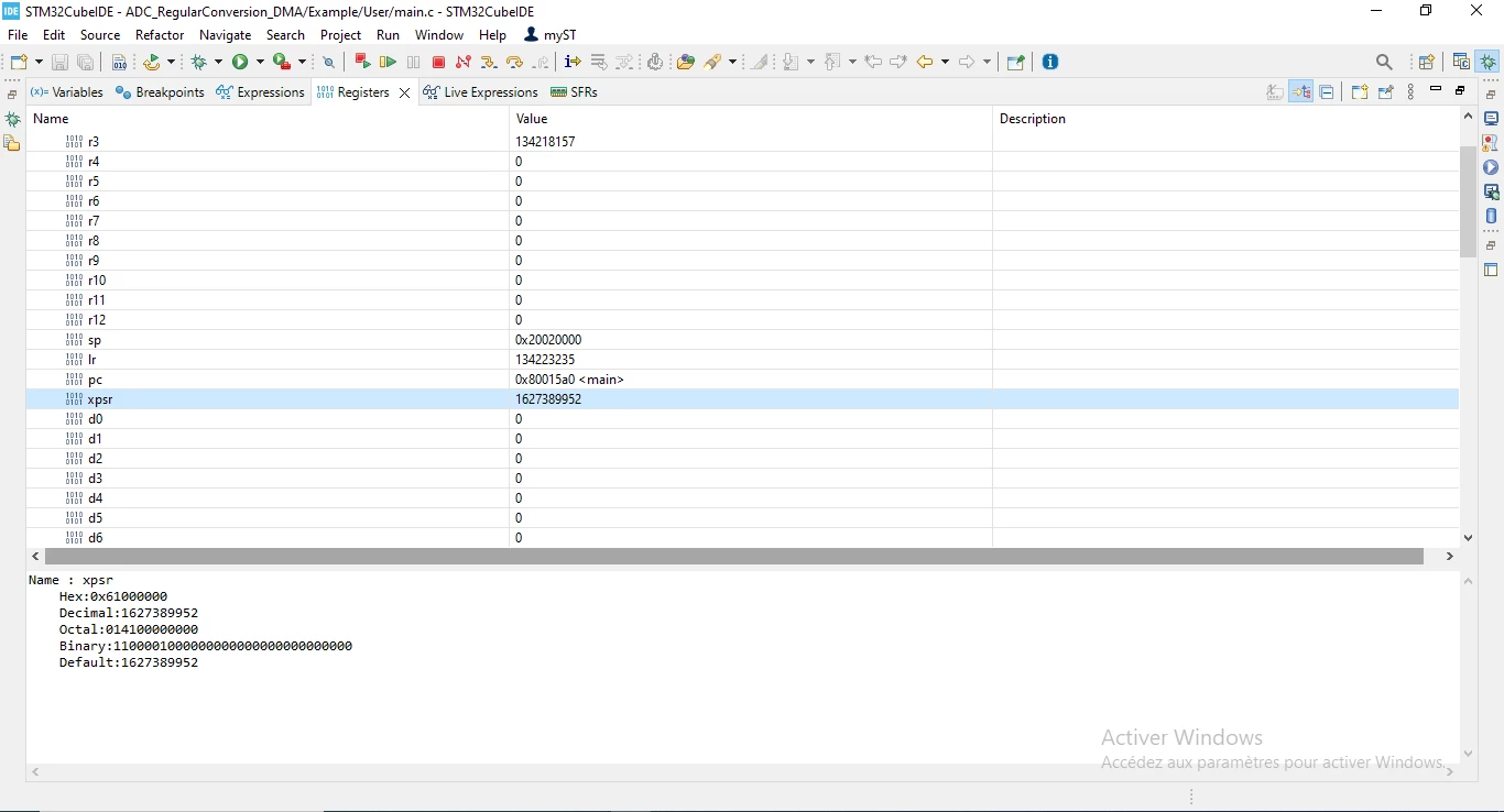

Is there a way to split the XPSR register view up so you can see each status bit by its name rather than the 32-bit value?
The SFRs have this feature, why do the general registers not have it enabled by default?

    Hello again
    Using CubeIDE this is the best result we can have.
    I hope you can use it with your students.
    Best regards.

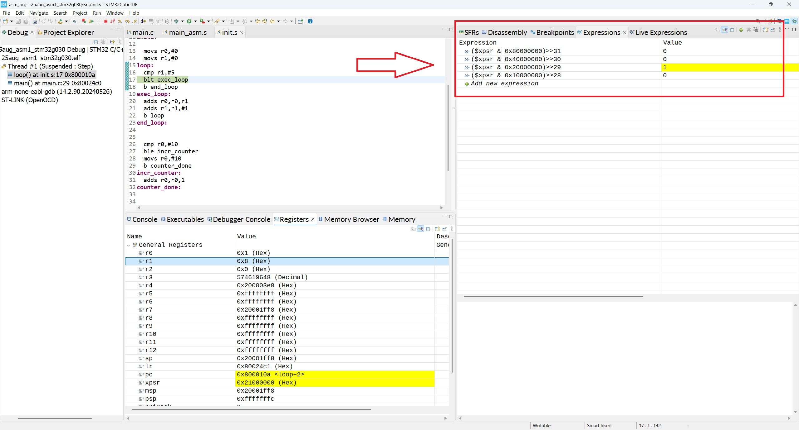

    Hi Glenn,
    This work-around could be helpful?
    Glenn Andrews
    Mar 2, 2025 9:27 PM UTC
    Interesting idea. I might try setting that up for next year's class.
