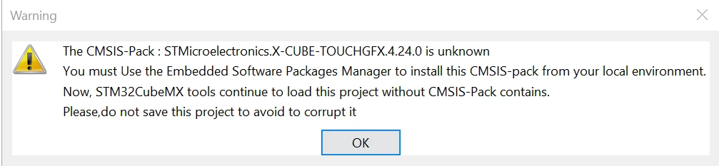

I´ve just created a new project with TouchGFXDesigner 4.24.0.
When trying to compile the project in STM32CubeIDE the theres no valid CMSIS package for this version...
Any idea?

    Sorry I can't help. Here as I have the same issue.
    Hello ST where is the TouchGFX 4.24 package for CubeMX/CubeIDE?

    Maybe this?
    https://community.st.com/t5/stm32-mcus-touchgfx-and-gui/x-cube-touchgfx-4-24-0-is-out/td-p/683800
    Note : TouchGFX Designer 4.24.0 MUST be used with STM32CubeMX 6.11.0 or above (link to download STM32CubeMX).
    Attention : If X-CUBE-TOUCHGFX 4.24.0 is not available in STM32CubeMX software yet, please navigate to "Help > Manage embedded software packages > STMicroelectronics > X-CUBE-TOUCHGFX". Then click on "From Local ..." and navigate to the x-cube-touchgfx-4-24-0.zip file to install the new pack inside STM32CubeMX.

    Thank you @AMars.4 This has allowed me to get 4.24 into CubeMX. Sadly I'm busy with something else just now and can't try further, but on the face of it this is our solution
