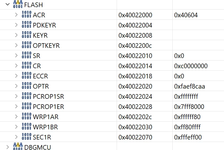

WRP2A and WRP2B registers are not showing on the SFRs tab
I'm working on a project that's using an STM32G484CEUX. The WRP2A and WRP2B registers are not showing under the FLASH peripheral of the SFRs tab:
The device is running is dual bank mode.
I have added them to the .svd file, but I think they should already be there?
Edited to correct grammar.

Hello @CTapp.1 ,
Thank you for bringing this issue.
It has been reported to STM32CubeIDE development team.
Internal ticket number:  204474 (This is an internal tracking number and is not accessible or usable by customer)
Thanks.
Mahmoud

Hello @CTapp.1 ,
First let me than you for posting.
For more investigation, I suggest that you provide the STM32CubeIE Version.
Thanks.
Mahmoud

Mar 4, 2025 9:24 AM UTC
Sorry, I meant to add that. I am using 1.17.0.
