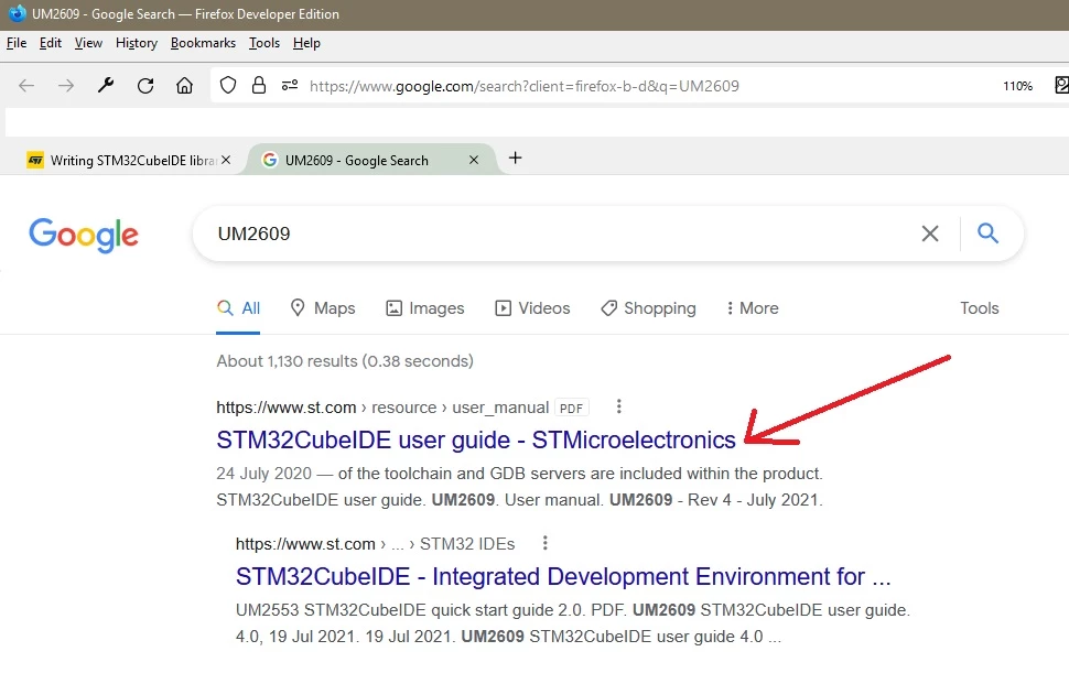

MCUpwr
Where can be downloaded this user manual UM2609 rev1? I can't find it anywhere on the ST site or web.
MCUpwr
Thanks m12lrpv, but I need rev1, here is only rev4.
m12lrpv
m12lrpvAuthor
Why do you think you need rev 1? Rev 4 is more current and won't contain as many errors as rev 1
MCUpwr
Because it doesn't have this chapter "see chapter 2.5.0 - Include libraries. Assumes UM2609 rev1..."
mattias norlander
Chapters in the UM2609 will have new numbers when we add new chapters preceding the one you are looking for. Have a look at chapter 2.5.8 - Include libraries in the latest manual version. Which CubeIDE version are you relying on? Probably the latest version of the UM2609 will be OK also for a number of older CubeIDE versions...
MCUpwr
Tnks
