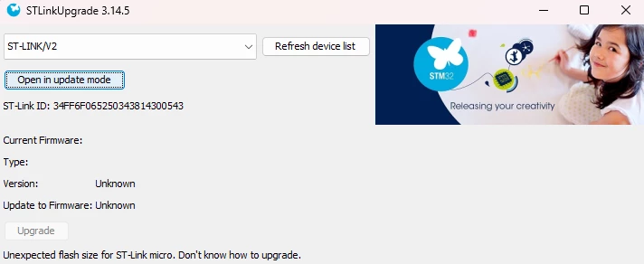

Hello all,
I have updated the STM32Cube IDE version to the 1.15.0, it has own STLinkUpgrade tool which is also updated to version 3.14.5. But a problem arised. It wants me to update my STLink V2 firmware. When I tried, It gives error like:
"Unexpected flash size for ST-Link Micro. Don`t know how to upgrade."

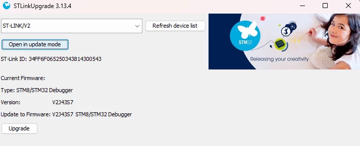

But I can use the older version 3.13.4 without any problem:
Is there a problem caused by 3.13.5 or caused by my ST-Link V2?

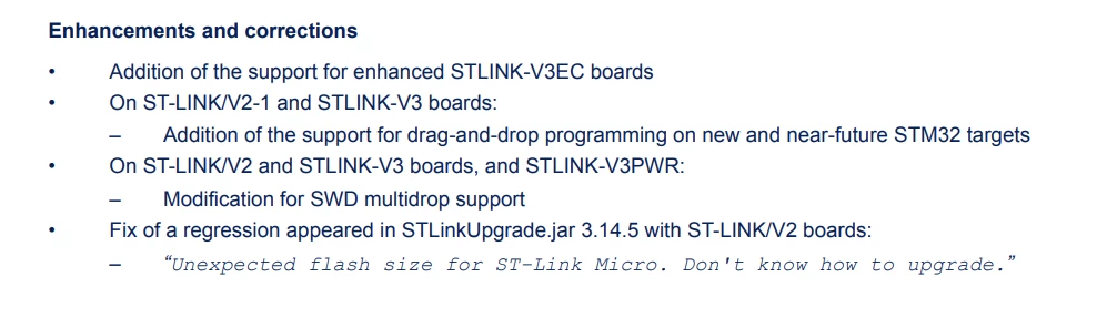

    Best answer by mcagriaksoy
    Summary: I tried with the latest ST-LINK Updater exe version 3.15.6 and my problem has been resolved.
    Document: Firmware upgrade for ST-LINK, ST-LINK/V2, ST-LINK/V2-1 and STLINK‑V3 boards - Release note
    It is happy to see my issue on fixes issues list.
    The newer version of updater is not embedded on IDE yet. You need to download from here: STSW-LINK007 - ST-LINK, ST-LINK/V2, ST-LINK/V2-1, STLINK-V3 boards firmware upgrade - STMicroelectronics

    Hello @mcagriaksoy
    Can you give more details about the board/MCU that you are using.
    Best Regards.
    STTwo-32
    March 20, 2024
    Hello, @STTwo-32 I am using STLink V2, my MCU is "STM32G491CCU"
    Bob S
    March 20, 2024
    How about a picture of the bottom side of the STLink.  There are quite a few clones out there.  This may be that the newer updater version had more robust checks for clone units.  Just guessing here.

    mcagriaksoyAuthorBest answer
    April 18, 2024
