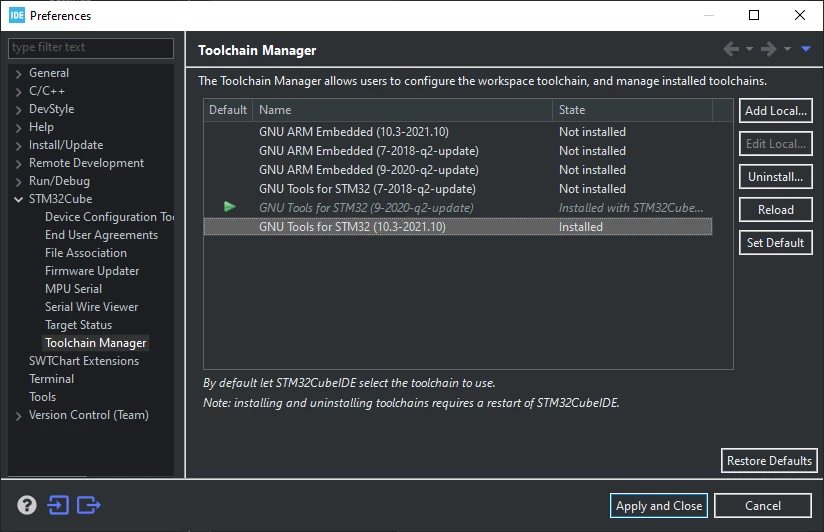

Hi All,
today I have installed new STM32CubeIDE 1.8.0. Despite the current toolchain 9-2020-q2 is very old the new IDE does not update it. Will there be any GNU Tools for STM32 updates, or I should now use GNU Tools for ARM?
Regards,
Dmitry

Stepan Martinek
November 30, 2021
HI,
I just did the full install because it is recommended by release notes. Then you need to install the 10.3 toolchain manually from within the IDE.
PS: Be aware that GCC 10.3 does not have full C++20 support. There are still some things missing (modules for example) and fully supported in GCC 11. But I would say 90% of C++20 is there.
DmRozhd
DmRozhdAuthor
November 30, 2021
Hi Stephan,
Thanks, but I have understood this already. My question is how should I do it? There is no new toolchain in the Toolchain Manager.
Regards,
Dmitry
Stepan Martinek
Stepan MartinekBest answer
November 30, 2021
That's strange. I did no extra steps. The toolchain was right there.0693W00000GZQyaQAH.png
