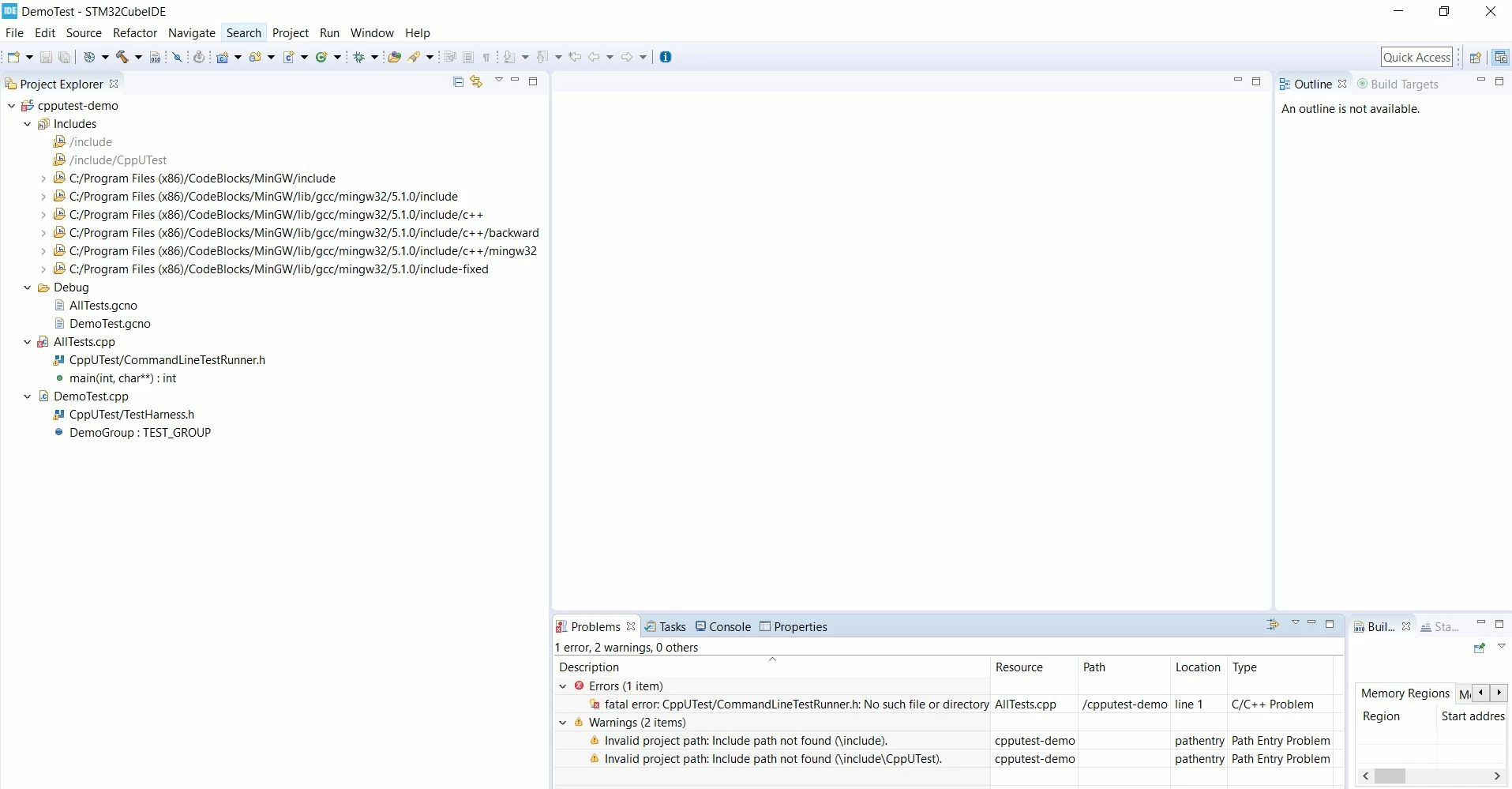

DCyr
August 4, 2019
I downloaded the cpputest-demo and opened the project with STM32CubeIDE and got the message that it couldn't find "CommandLineTestRunner.h". I searched my entire disk and it does not exist. (See attached). The IDE just updated itself today, so it's the latest version.0690X00000981BWQAY.jpg

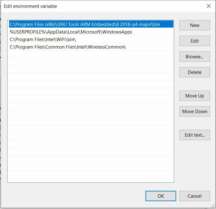

DCyr
August 3, 2019
Thanks for your help. I appreciate you taking the time to direct me, but I still don't know what to do after installing MinGW-w64. The compiler seems to have installed OK, but am I supposed to set up a path pointing to the C:\MinGW directory or C:\Program Files directory? What path am I supposed to add? And is it a system variable or a user variable?
I had downloaded another compiler (see attached) and added a path for it, but the SMT32CubeIDE never saw it and continued to complain that I had to add a toolchain. So apparently there is something else I am not doing and don't know what or how. Maybe my problem is I am an electronics engineer, not a systems software specialist!?!?!?
