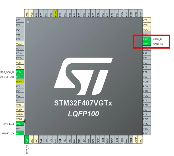

Why there is no PA12 & PA11 pins on STM32F407-VG DISC1 board.
I would like to write a CAN application. The ioc assigns PA12 and PA11 as CAN Tx and CAN Rx respectively. However, when I checked the headers on board, I can not find out these pins.
Am I missing something ?
Thank you.

    Perhaps review the schematic?
    https://www.st.com/en/evaluation-tools/stm32f4discovery.html#cad-resources
    https://www.st.com/resource/en/schematic_pack/mb997-f407vgt6-e01_schematic.pdf
    Aren't they used for the south-end USB connector?
