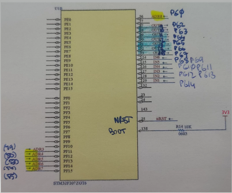

Custom board.
Pay particular attention to BOOT0 being pulled LOW, the VCAP capacitors/voltages, the analogue supplies.
Watch the clocking source, perhaps use HSI+PLL as HSE on NUCLEO provided by a constant 8 MHz clock.

0693W00000Y8QRjQAN.pngI noticed that Nucleo board has the first configuration values by default (it is possible to see looking at the Nucleo board schematics). So when it is programmed with ST-Link GDB series, binary file is downloaded and writen on the main flash memory - before PC counter starts to increment its count -.
The custom board is an heritance from external designer. I took a look to the scheme and I could see that BOOT0 is being pulled up to 3.3V.
Obviously the start system seems not to be the same. But the fact that I don't know if this configuration was thought (even needed) to program the memory of the mcu using SEGGER J-Link.
Could it be reasonable that BOOT0 must to be tied to high?
I think not, because this board is using BOOT1 pin (B2) as a digital input, but... who knows.
I will make some fixtures on the board in order to get GND on BOOT pin instead VCC and I will try to debug once again.
Regarding clock I'm using HSI when I debug on custom board. But as I said tick timer interruptions for HAL layer drivers are not being produced after they are enabled, so clock is unable to be configured. Because I'm using HAL layer libs.
I can also see how no capacitors are connected to VCAP1 and VCAP2. According to datasheet reading this could cause internal circuitry missfunction. I hope this 1.2V internal regulator not to be damaged when SEGGER was connected and used for debugging.
