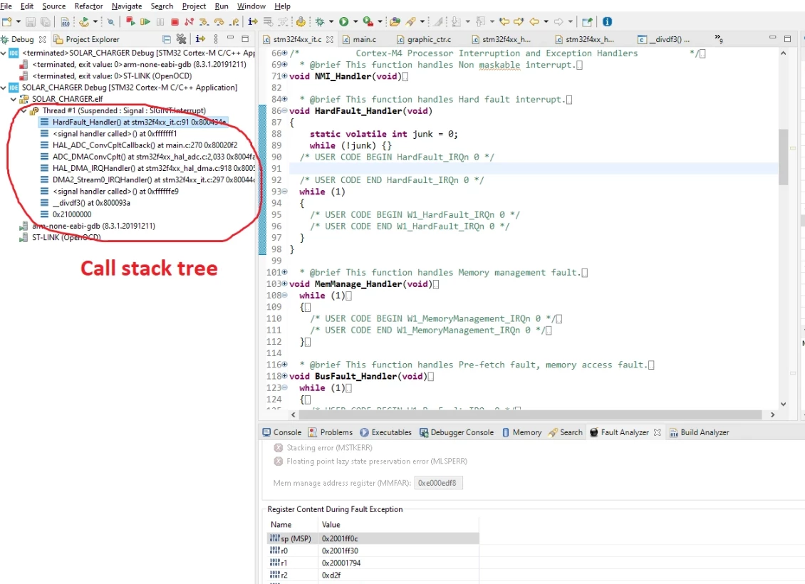

Why STM32CUBEIDE can't find Call Stack in debug view
I am debug project for DMA, I want looking for interrupt vector related information, Copilot suggested use “Call Stack”.
I did try “Reset ALL perspectives”, “Window → Perspective → Customize Perspective”, I can’t find this function.

Hello ​@Richard Li
The call stack is located in the debugger view, which shows the chain of function calls as shown below:
KR, Souhaib

I got Copilot replay, Ver 2.1.1 inside with a bug, Call Stack function doesn’t work, will fix at later version 6.2, 6.3?
