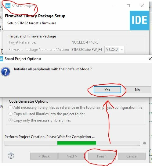

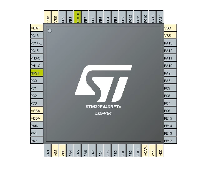

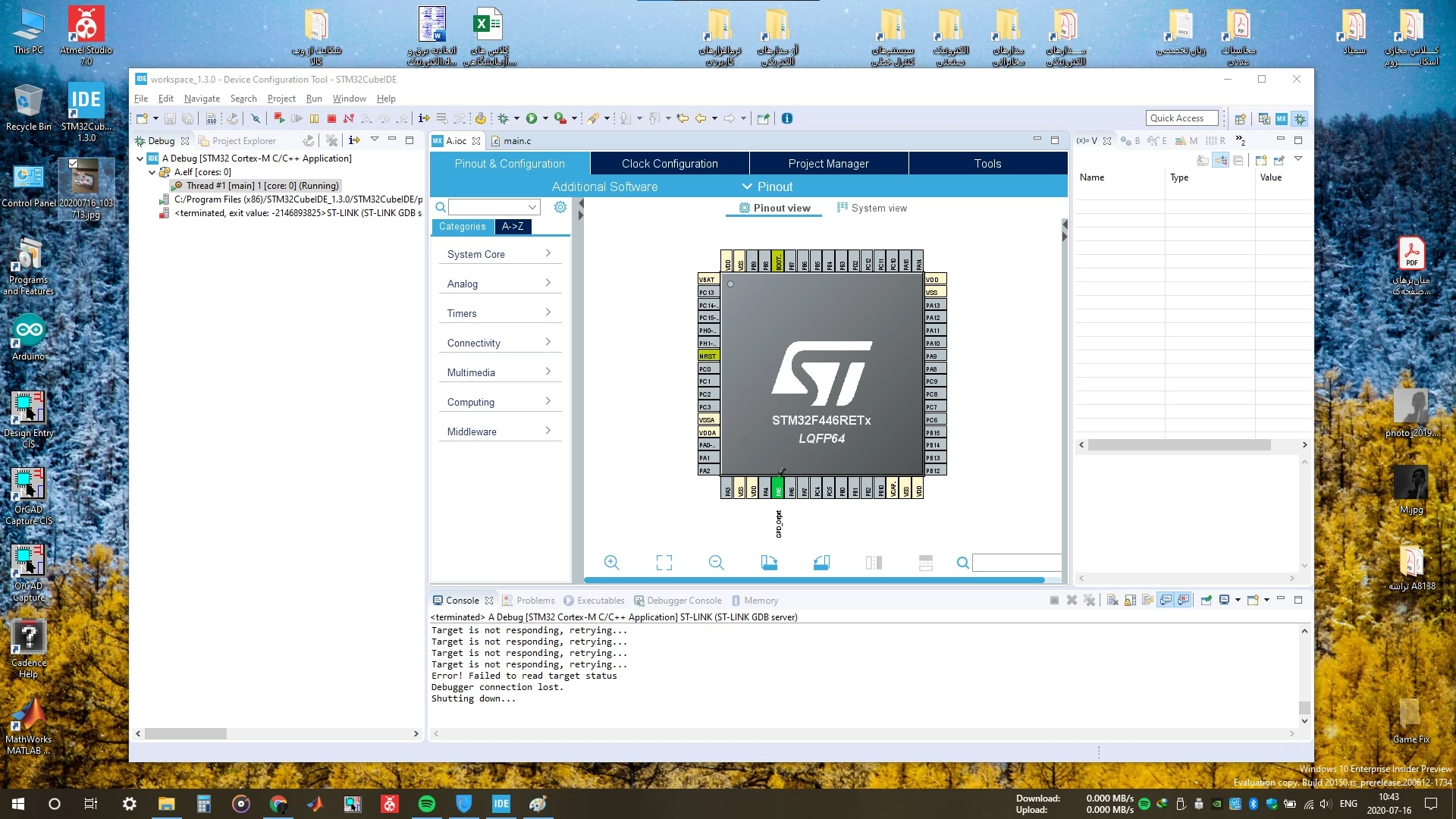

When I using STM32CUBEMX that's config pins like this [1], but in stm32cubeide dose't like that [2].

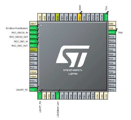

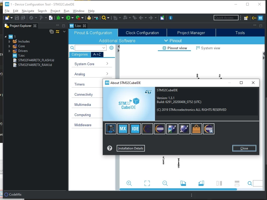

@Msadr471 I can change GPIO like in STM32CubeMX. my STM32CubeIDE version is V1.3.1
Msadr471
Msadr471Author
July 17, 2020
Yah, I know it. me too
I can change anything.
But first time when I create new project IDE doesn't config GPIO like Picture 1.
it show me picture 2.

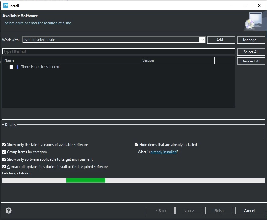

My IDE Version:
Cartu38 OpenDev
Graduate II
July 17, 2020
My guess is you have ommitted to answer Yes to default board setup. Have a neew try creating your project File > New > STM32 Project
Msadr471
Msadr471Author
July 17, 2020

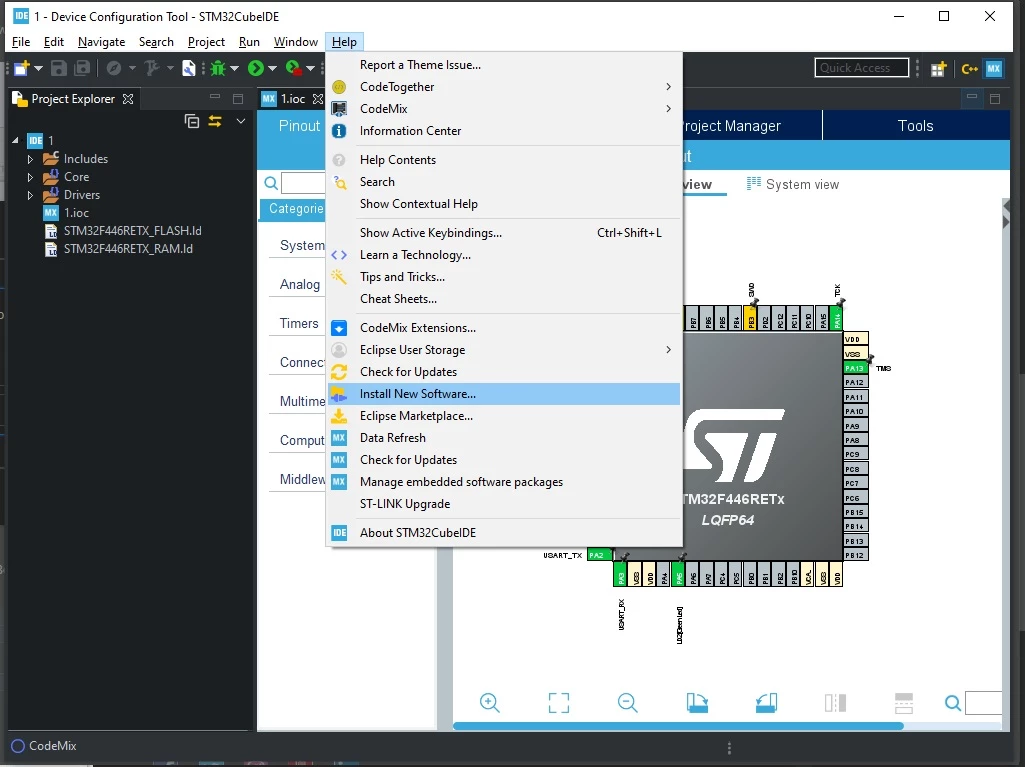

I solved the problem.
in this section, I installed a package, and STM32cubeIDE upgraded.
I still do not know what the problem was, but in the end, the problem was solved.
AShap.2
Visitor II
June 11, 2022

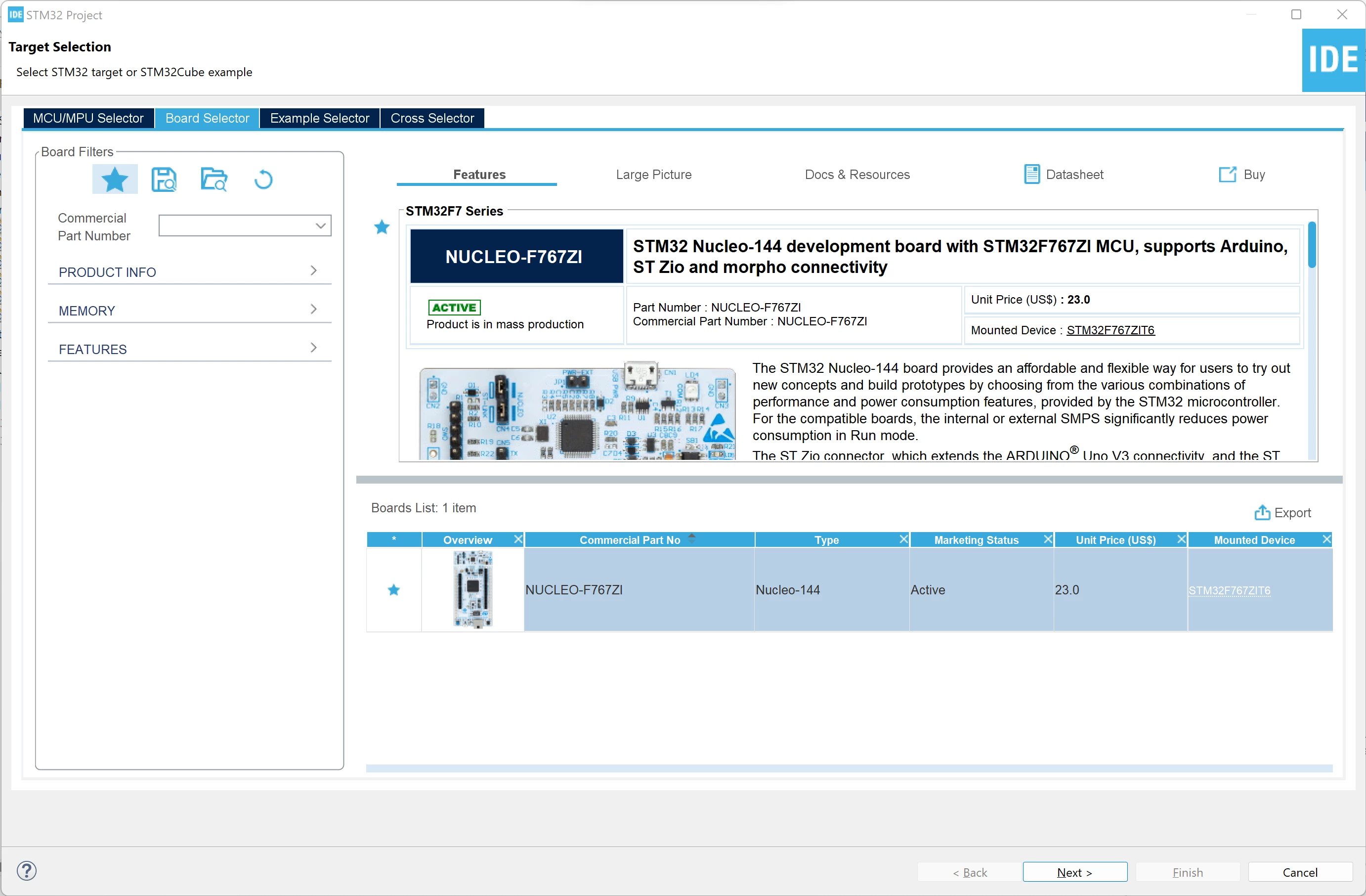

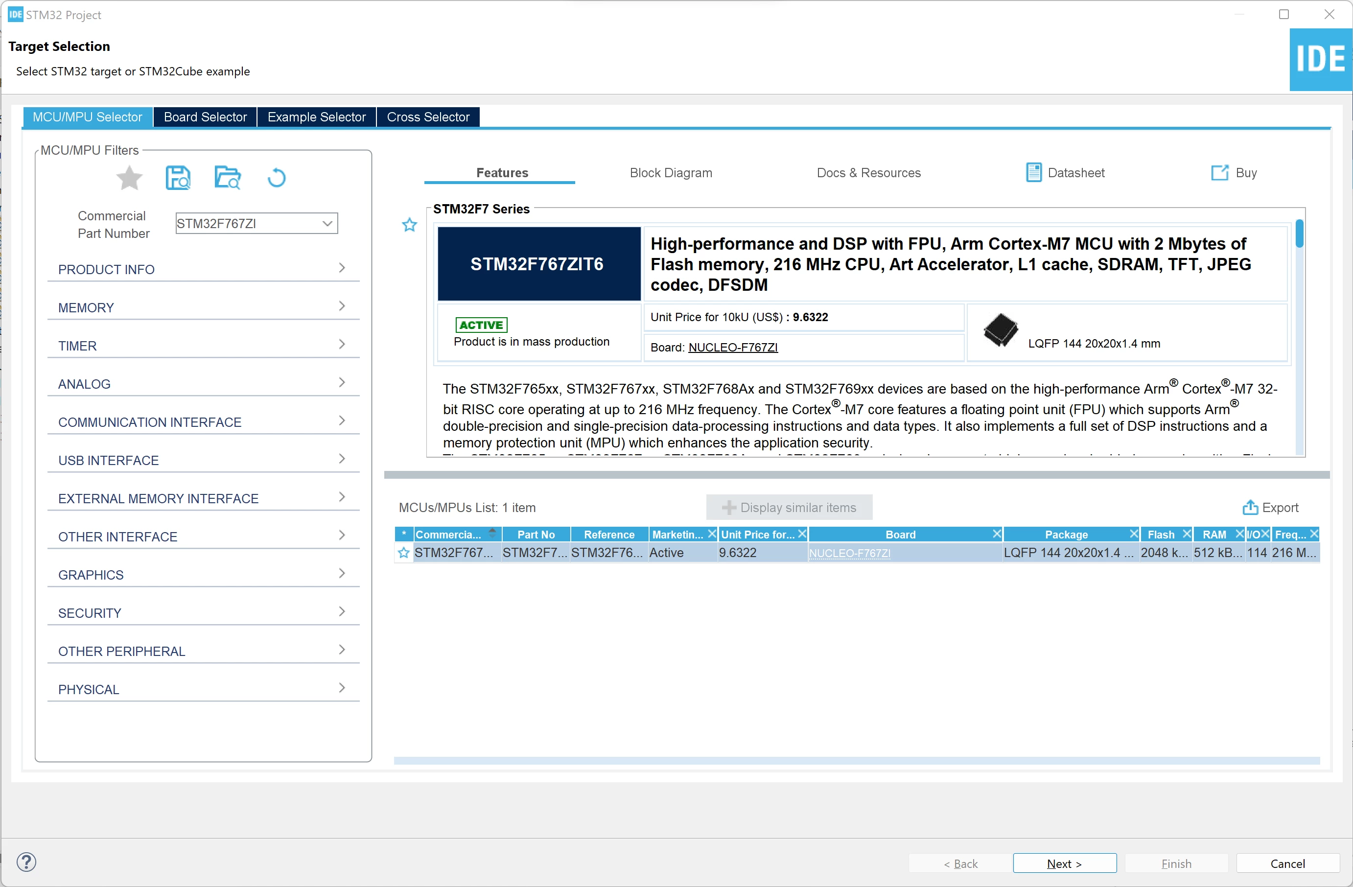

It happens when you select MCU/MPU
Instead of Board Selector
