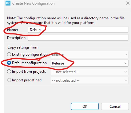

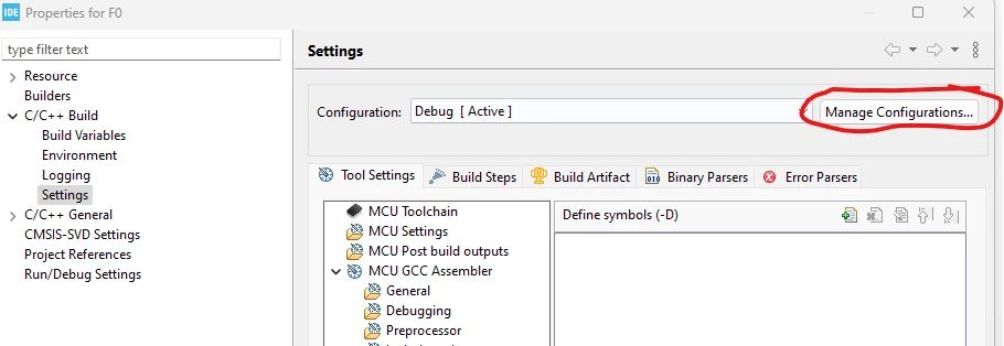

No option. Hardcoded behavior if debug type build configuration.
As workaround possibly remove original Debug configuration and create a new one based on Release type
0693W00000Y8n2wQAB.pngTakes care starting from Release type, compiler optimizations are not debug compliant so you will have to set them to proper values
