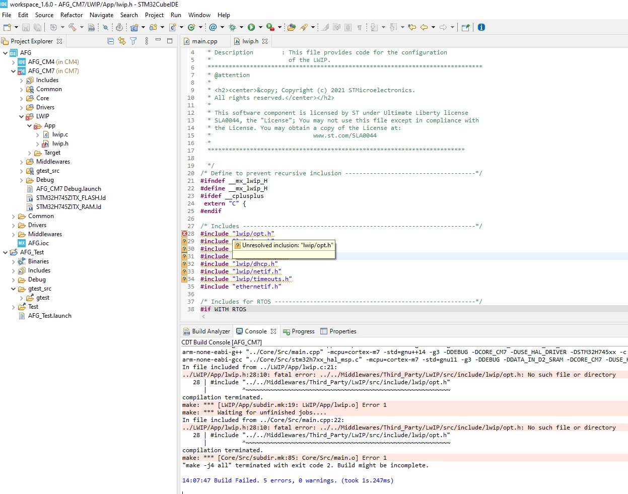

I'm trying to compile my program, but it doesn't work due to an error probably related to LwIP includes.

I've found online that there's a problem with LwIP's errno file.
https://community.nxp.com/t5/Digital-Signal-Controllers/I-did-not-compile-quot-Hello-World-quot-cpp-code-in-MCUXpresso/m-p/983807
Doesn't fix my problem at all, the output is no different.
Anyone know's the solution?
UPDATE:
Seems to be the issue... anyone able to help me?

May 3, 2021
Hello @Jvan .10​  it seems from picture that header file is not properly included in project.
If Its possible you can share your project folder here to try.
Saurabh

December 16, 2021
Just add <sys/errno.h> at the beginning like:
#pragma once
#include <sys/errno.h>
#include <string>
#include "lwip/udp.h"
<sys/errno.h> define ENOTSUP and more
(169) #define ENOTSUP 134 /* Not supported */
