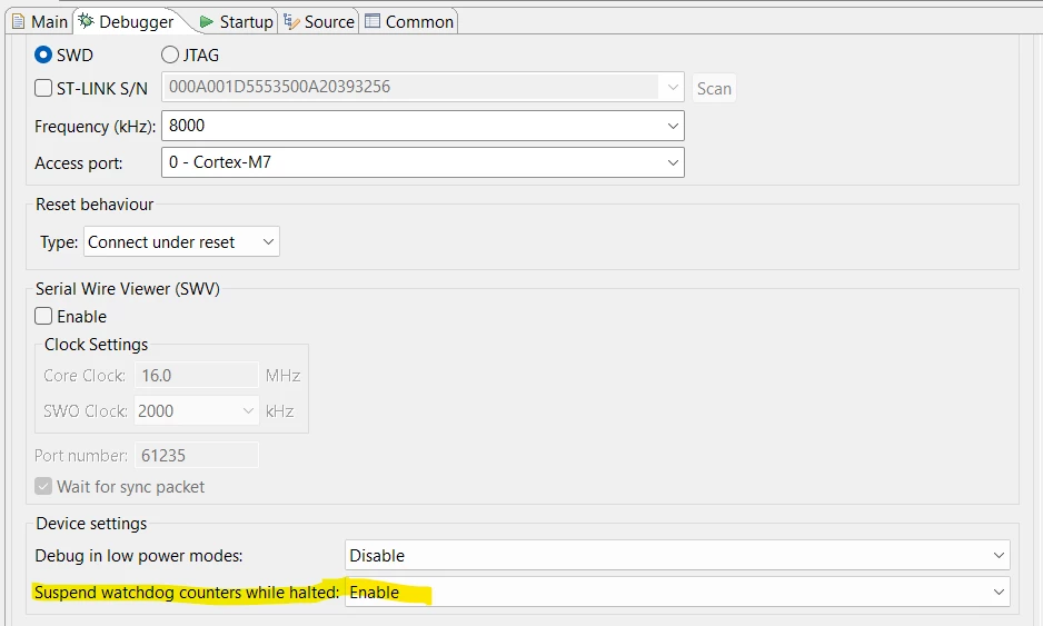

While trying to debug the program I get the following error:
CM4 Failed to read all registers
FAILED to REGISTER Values from the target
What should I do?
Best answer by manto.1
I managed to solve the problem with enableing suspension of watchdog in debug settings.

EOzde.1
August 8, 2022
Can you share the SystemClock_Config function
manto.1
manto.1AuthorBest answer
August 8, 2022
