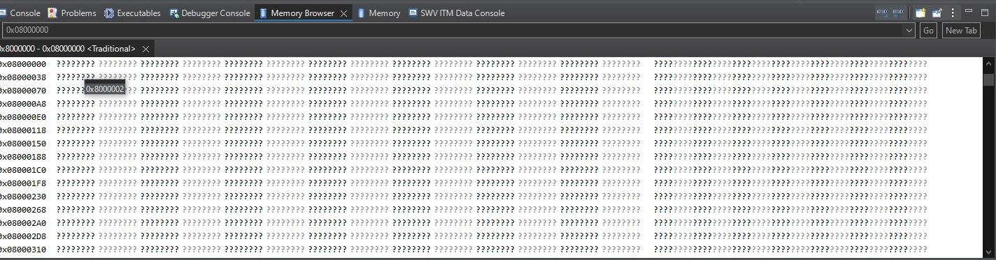

Why cannot properly see opcodes on memory browser ?
I can see the addresses when I hover over them, but I can't see the opcodes. Is there a setting to fix this or is it broken?

AScha.3
AScha.3Best answer
June 9, 2024
Just to mention : memory can only be read, when debug stop core, at a breakpoint or click "suspend" .
While running, only last readed values or "????" shown.

Which STM32 ?
Erased FLASH, or content expected?
June 8, 2024
I am using the STM32F407-DISC and trying to see the content of memory. I am a newbie so sorry for missing info.
Tesla DeLorean
Guru
June 8, 2024
Suggests this is a connectivity issue with the ST-LINK/V2 on the STM32F407-DISCO, make sure it has most current firmware. Check it is readable in STM32 Cube Programmer
The F4 doesn't have ECC (error correction / checking) so reading blank memory shouldn't fault, which could be the case for H7 parts, say. Those devices might reflect unreadable memory with '????' displays.
