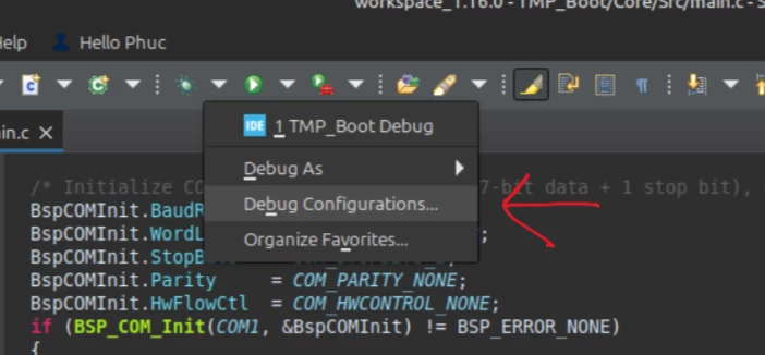

First, go into the IDE with a basic project that has proven to be able to program the board and debug. Then look into the Debug Configuration settings, which is in the dropdown menu of the debug button.

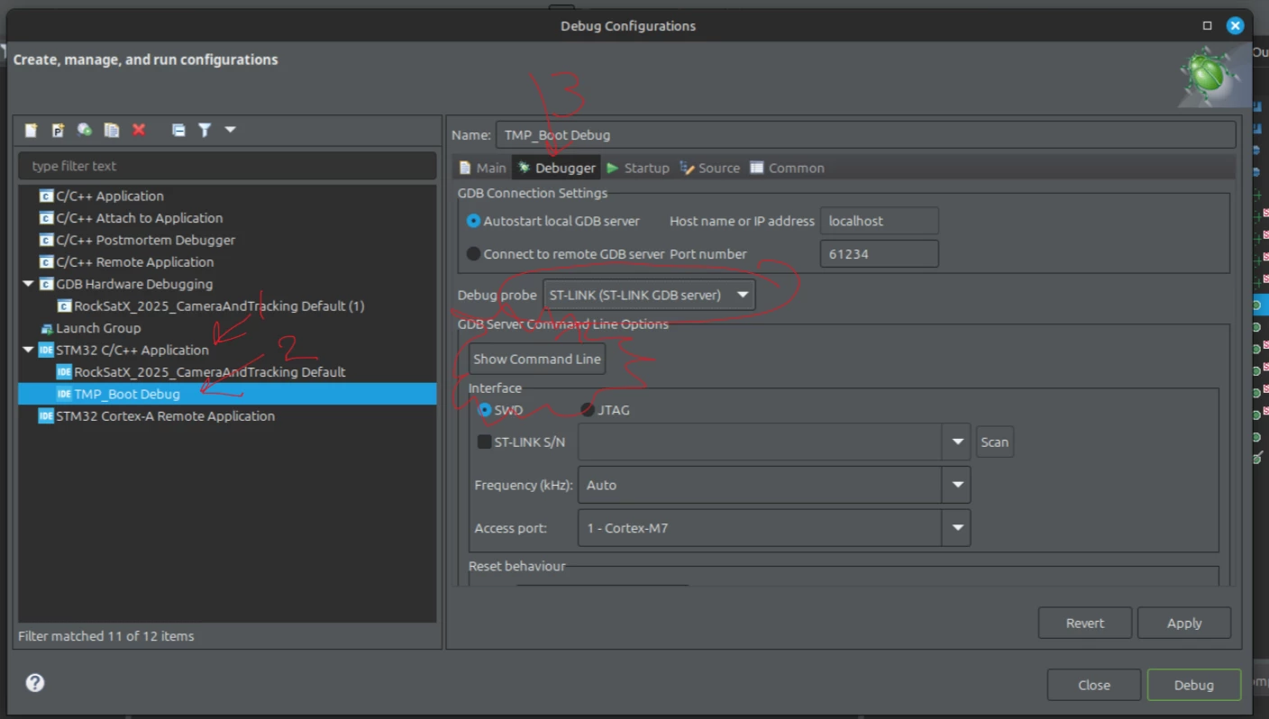

Then find the project and look in the Debugger tab, in here is where CubeIDE configures the connection of the debugger. One of the things you can do in this tab is Show Command Line, which tells you "exactly" what CubeIDE is doing.
Now I put "exactly" in quotes because the command for calling ST-LINK_gdbserver worked only partially. The program recognized the ST-LINK and the target device, but no complete connection was established; a busy wait happens indefinitely. So CubeIDE is still doing something additional that I don't know about.
I have no love for ST-LINK_gdbserver at this point, though, so what I then did next was change the debug probe to ST-LINK (OpenOCD) and once again copy the command line options, which was this for me:

So I looked back at the command line options for ST-LINK_gdbserver according to ST32CubeIDE...
/home/phucxdoan/st/stm32cubeide_1.16.0/plugins/com.st.stm32cube.ide.mcu.externaltools.stlink-gdb-server.linux64_2.1.400.202404281720/tools/bin/ST-LINK_gdbserver -p 61234 -l 1 -d -s -cp /home/phucxdoan/st/stm32cubeide_1.16.0/plugins/com.st.stm32cube.ide.mcu.externaltools.cubeprogrammer.linux64_2.1.400.202404281720/tools/bin -m 1 -g
... and as stated, running this (at least on my machine) just results in a busy wait where the debugger never actually connects. I expect STM32CubeIDE to be executing this same command, but somehow it just isn't facing the same issue.
As it turns out, if you remove the "-l 1" argument:
/home/phucxdoan/st/stm32cubeide_1.16.0/plugins/com.st.stm32cube.ide.mcu.externaltools.stlink-gdb-server.linux64_2.1.400.202404281720/tools/bin/ST-LINK_gdbserver -p 61234 -d -s -cp /home/phucxdoan/st/stm32cubeide_1.16.0/plugins/com.st.stm32cube.ide.mcu.externaltools.cubeprogrammer.linux64_2.1.400.202404281720/tools/bin -m 1 -g
IT NOW WORKS. I guess ST-LINK_gdbserver was having issues with logging of all things? Ugh. Weekend wasted.
