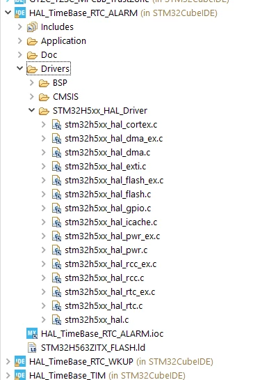

When I open projects from STM32CubeH5 in the IDE, all the include directories and header files are not shown in the workspace. Compiling succeeds, so the paths are correctly set in the project settings. However, there is obviously somewhere a filter setting or similar that makes the include directories invisible. Does anybody knows how to make them visible again?

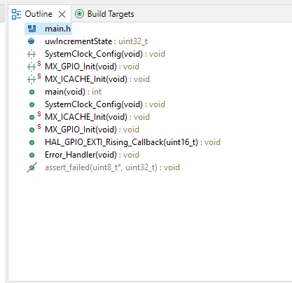

    It has been done this way to improve the user experience. You can always find your .h file in the outline subwindow.
    For example in your main.c, you will find a tab Outline on the GUI of STM32CubeIDE (usually on the top right). Alternatively you can open this window by Window > Show View > Outline
    You just need to double click the main.h to open it.

    Three lines above "Drivers" you see "includes". There are all your include directories. This is how Eclipse CDT designers made it.

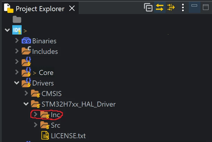

    @Pavel A. I can see include directories in my Project Explorer, outside of the general "Includes" folder. Can you not? There has to be a setting or configuration somewhere that would explain the difference. Google isn't helping here, but there are common complaints similar to the poster.

    Agreed. Just think it's weird that the behavior is different here. I don't remember configuring anything different in my project.
