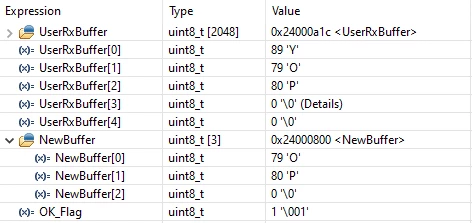

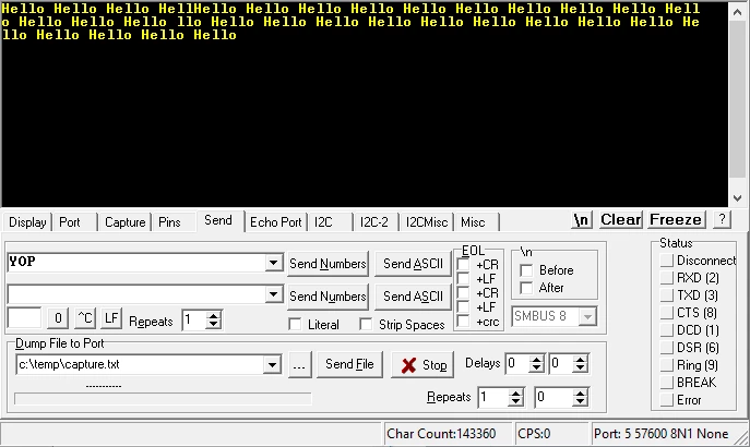

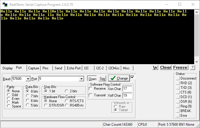

When I use Realterm, I have the following data received by the PC:
When I send data to the MCU with RealTerm (e.g. the string "YOP") :
Using the debugger, I suspend the process and watch the data, which have been received:

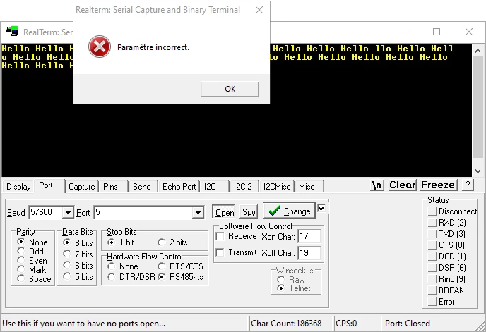

However, as soon as I enable the I2C, I can't communicate with RealTerm anymore (I also tried Putty with the same results).
However, the PC still detect the VCP as it can be seen in the screenshot of the device manager below :
It's not a part of my code which have been deleted by the STM32CubeIDE, since as soon as I disable again the I2C communication and generate the code again, the communication is working fine again.
