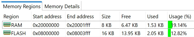

I have created a new project and built it. The build analyser shows:
I then added the following at file scope:

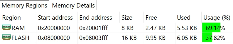

int8_t position[ 4096 ]; // Default zero initialized array
The build analyser then shows:
The 4k increase in RAM usage makes sense, but not the 4K increase in FLASH.
The console shows:

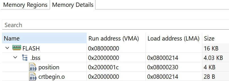

The build analyser also shows:
Why is 4k being added to the .bss section in FLASH for the position object?

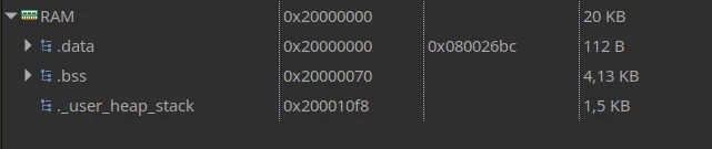

AScha.3
September 25, 2024
Which chip ?
You set something strange...
on F103C8 :
I tried just to add your 4K position array, and yes, it needs 4KB ram, bss is there, nothing in flash:
with optimizer on -O2 .
The linker script should have it in ram - did you change it ?
 .bss :
 /* This is used by the startup in order to initialize the .bss section */
 _sbss = .; /* define a global symbol at bss start */
 __bss_start__ = _sbss;
 *(.bss)
 *(.bss*)
 *(COMMON)
 . = ALIGN(4);
 _ebss = .; /* define a global symbol at bss end */
 __bss_end__ = _ebss;
 } >RAM
