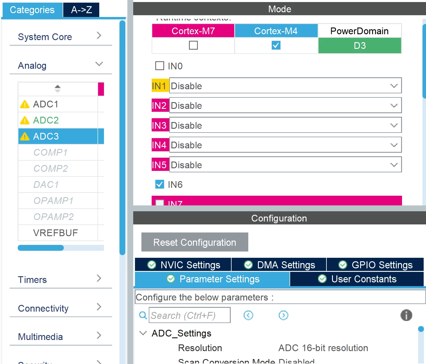

Why am I getting an ADC HAL_ERROR from the CubeIDE generated code.
 I’m new to STM32 development so I’ve been using the CubeIDE – Device Configuration Tool to generate most of the code, and HAL calls.
I’m using an stm32h747xih (Dual core M7 & M4 Discovery Board) and have being trying to get the ADCs to work. I’ve started with a single shot measurement.
My code is below:
HAL_ADC_Start(&hadc3);
HAL_ADC_PollForConversion(&hadc3, 5000);
sine = HAL_ADC_GetValue(&hadc3) - 512;
HAL_ADC_Stop(&hadc3);
After a lot of fault finding I’ve began to suspect the HAL_ADC_Start call. In this HAL, when this line is executed:
/* Enable the ADC peripheral */
 tmp_hal_status = ADC_Enable(hadc);
tmp_hal_status shows a HAL_ERROR and returns without starting the ADC measurement.
After Googling this problem, someone mentioned checking the clock for the ADC was setup. I believe this should be done on the M7 in the SystemClock Config:

I can’t see where the clock for the ADC is setup in the code. If this is the problem, I’m not sure how to add this in the CubeIDE, or even if I’m on the right track. Is anyone able to offer some advice?

Show the full code, at least main.c. The ADC clock is enabled in the *_hal_msp.c file in generated code and called via HAL_ADC_Init which is called in something like MX_ADC_Init.
Since it's a dual core chip, possibly you haven't assigned the ADC peripheral to a core, so it's not initializing it. Should be an option to assign it to the M7 or M4 core in the CubeMX file.

The ADCs are assigned to the M4:
There's very little code from me. However, this is the main for M4:

 /* USER CODE BEGIN 3 */
 /* USER CODE END 3 */
 * @retval None
void SystemClock_Config(void)
 /** Supply configuration update enable
 HAL_PWREx_ConfigSupply(PWR_DIRECT_SMPS_SUPPLY);
 __HAL_PWR_VOLTAGESCALING_CONFIG(PWR_REGULATOR_VOLTAGE_SCALE1);
 while(!__HAL_PWR_GET_FLAG(PWR_FLAG_VOSRDY)) {}
 RCC_OscInitStruct.OscillatorType = RCC_OSCILLATORTYPE_HSI;
 RCC_OscInitStruct.HSIState = RCC_HSI_DIV1;
 RCC_OscInitStruct.PLL.PLLSource = RCC_PLLSOURCE_HSI;
 RCC_OscInitStruct.PLL.PLLM = 12;
 RCC_OscInitStruct.PLL.PLLN = 150;
 RCC_OscInitStruct.PLL.PLLP = 2;
 RCC_OscInitStruct.PLL.PLLQ = 2;
 RCC_OscInitStruct.PLL.PLLR = 2;
 RCC_OscInitStruct.PLL.PLLRGE = RCC_PLL1VCIRANGE_2;
 RCC_OscInitStruct.PLL.PLLVCOSEL = RCC_PLL1VCOWIDE;
 RCC_OscInitStruct.PLL.PLLFRACN = 0;
 Error_Handler();
 |RCC_CLOCKTYPE_PCLK1|RCC_CLOCKTYPE_PCLK2
 |RCC_CLOCKTYPE_D3PCLK1|RCC_CLOCKTYPE_D1PCLK1;
 RCC_ClkInitStruct.SYSCLKDivider = RCC_SYSCLK_DIV1;
 RCC_ClkInitStruct.AHBCLKDivider = RCC_HCLK_DIV2;
 RCC_ClkInitStruct.APB3CLKDivider = RCC_APB3_DIV2;
 RCC_ClkInitStruct.APB1CLKDivider = RCC_APB1_DIV2;
 RCC_ClkInitStruct.APB2CLKDivider = RCC_APB2_DIV2;
 RCC_ClkInitStruct.APB4CLKDivider = RCC_APB4_DIV2;
 if (HAL_RCC_ClockConfig(&RCC_ClkInitStruct, FLASH_LATENCY_2) != HAL_OK)
 Error_Handler();
 HAL_RCC_MCOConfig(RCC_MCO1, RCC_MCO1SOURCE_HSI, RCC_MCODIV_1);
 * @param None
 * @retval None
 /* GPIO Ports Clock Enable */
 __HAL_RCC_GPIOC_CLK_ENABLE();
 __HAL_RCC_GPIOA_CLK_ENABLE();
 __HAL_RCC_GPIOH_CLK_ENABLE();
 /*Configure GPIO pin : CEC_CK_MCO1_Pin */
 GPIO_InitStruct.Pin = CEC_CK_MCO1_Pin;
 GPIO_InitStruct.Alternate = GPIO_AF0_MCO;
 HAL_GPIO_Init(CEC_CK_MCO1_GPIO_Port, &GPIO_InitStruct);
/* USER CODE BEGIN 4 */
/* USER CODE END 4 */
 * @brief This function is executed in case of error occurrence.
 * @retval None
void Error_Handler(void)
 __disable_irq();
 while (1)
#ifdef USE_FULL_ASSERT
 * @brief Reports the name of the source file and the source line number
 * where the assert_param error has occurred.
 * @param file: pointer to the source file name
 * @param line: assert_param error line source number
 * @retval None
 /* USER CODE BEGIN 6 */
 /* USER CODE END 6 */
#endif /* USE_FULL_ASSERT */
AChap.1
AChap.1Author
March 14, 2022
Update: I've looked in the FSRs and can see the ADC3 peripheral clock is enabled (Bit 24 of AHB4ENR). So the generated code is enabling the ADC clock somewhere.
Is there a way of finding out what causes this HAL_ERROR? I'm running out of ideas of where to look.
Thanks,
Adrian.
