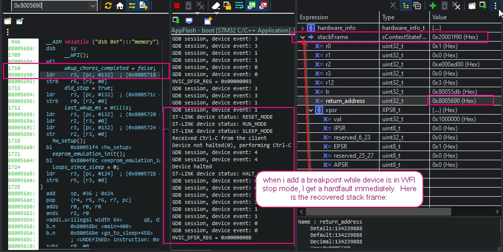

Why am I getting a hard fault when adding a breakpoint in the IDE while the device is in stop mode
Scenario is that I am debugging my application using ST-Link V2.
The device enters stop mode (with debugging still enabled). If I then add a breakpoint while the device is in stop mode, I immediately trigger a hard fault ISR.
This is new behaviour that seems to have only began happening recently with this project.
I therefore suspect it is either from some change in my app or from some change in Cube HAL drivers or IDE's debug layer after updating to STM32CubeIDE_v1.11.0
Below is a screenshot showing the recovered stack frame, and the assembly code and debug console output when the hard fault happens.
I am using STM32G030F6

Any update here?
I'm having the same issue on WB55, running using visualGDB 5.6R9 on visual studio.
I've also noticed that adding the following ASSERT definition causes this to happen every time I try to "Break All" (pause) with the debugger:
#define configASSERT( x ) if ((x) == 0) {__asm volatile("BKPT #01"); taskDISABLE_INTERRUPTS(); for( ;; );}
I'm using SEGGER J-LINK.

Have you got a HardFault handler, and have you looked at the info that provides?
Perhaps you've disabled clocks that the debugger needs ... ?

Adding more details:
When the configASSERT is define as a breakpoint
and I "Break All", the PC is inside the HAL_PWREx_EnterSTOP1Mode function, in the instruction
/* Request Wait For Interrupt */
__WFI();
When I press "Continue" I'm getting:
Received a SIGTRAP: Trace/breakpoint trap

This is likely because the breakpoints are implemented in the flash subsystem of the MCU. In stop mode most of the MCU's guts are not responding. Perhaps a J-Link with its "unlimited breakpoints" feature could help here.
Pavel A.
February 21, 2024
@dagan the SIGTRAP looks like a debug exception, quite expected when debugging. But the debugger gets confused and fails.You're using 3rd party tools: VisualGDB debugger and J-Link. Have you tried to reach their support?
