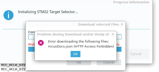

While opening the new project, I am getting the error like "Error downloading the following files: mcusAds.json(HTTP Access Forbidden". Kindly help me.

Which STM32CubeIDE release are you relying on ?
If old one please update ... (current is 1.6.0)

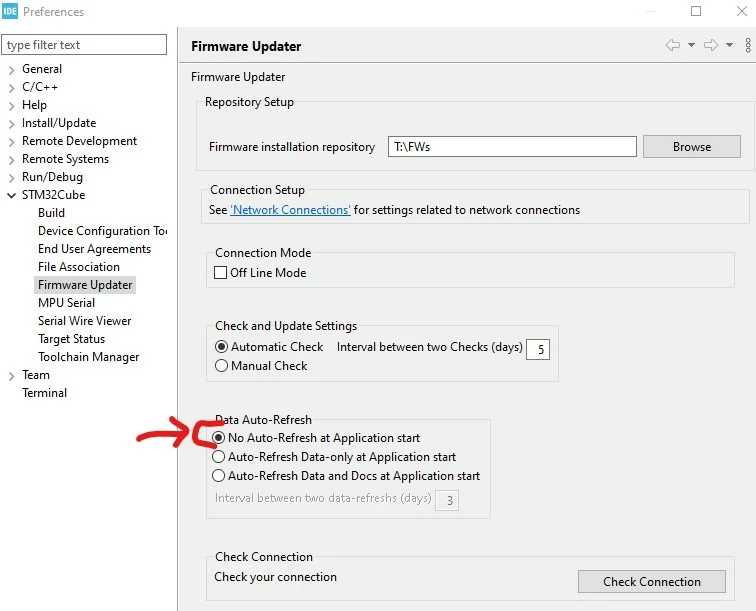

If recent release maybe local network issue. In order to workaround waiting for alive connection have a try to:
0693W000008xfFqQAI.jpgWould advice to come back to default setting as soon as possible then. If not you are going to possibly miss some important update at a time.
