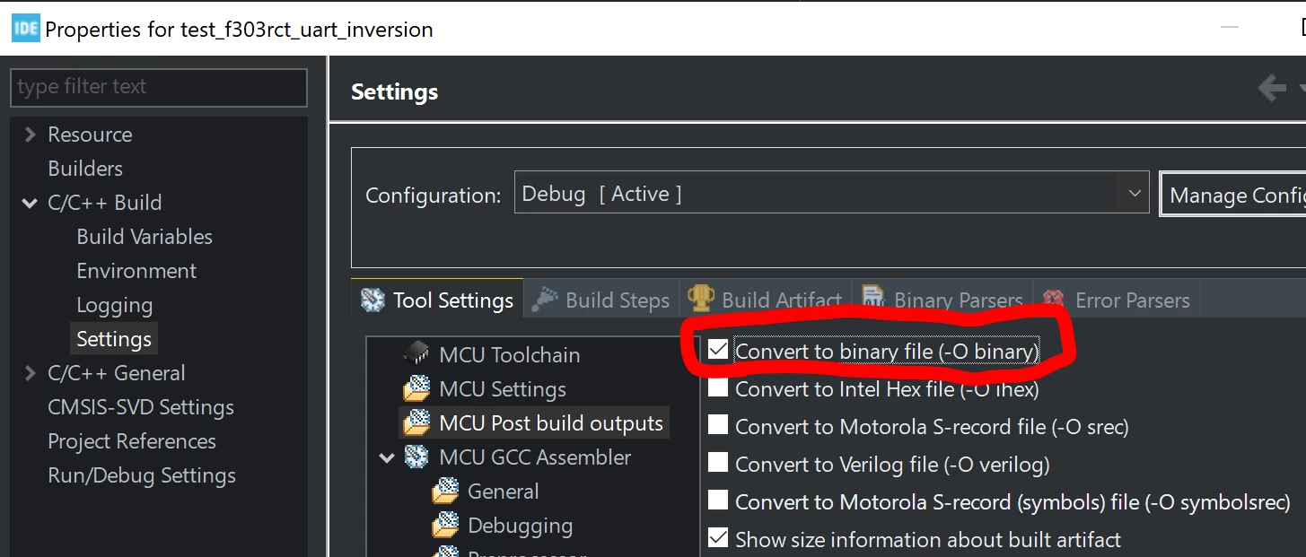

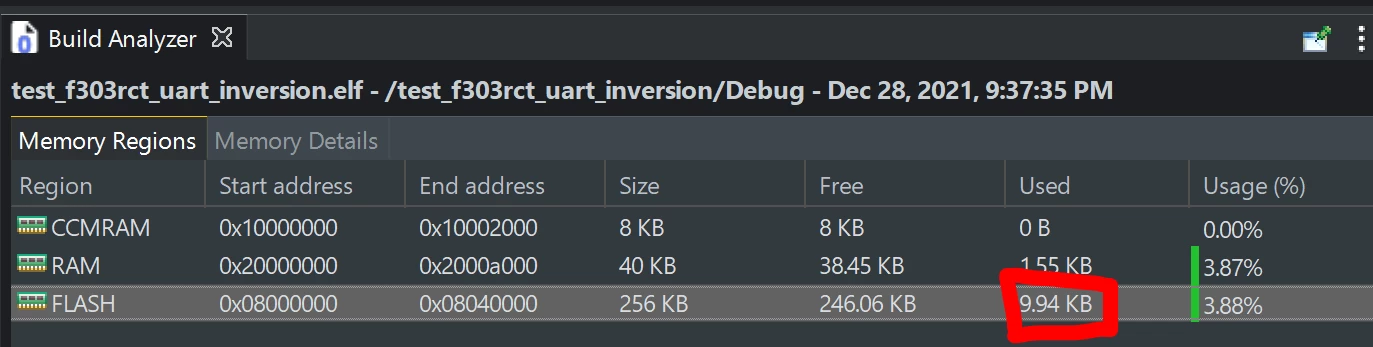

Where to check final binary size on CubeIDE1.8.0?
I want to know final binary size after build like IAR.
Currently final output os CubeIDE is Elf file, so I do not know what size it is.
(When I use IAR, It showed final binary size on terminal and could also generate binary file.)
Is there anyone know about how to check final binary size on CubeIDE?

When you successfully build a project, the size is output to the console. This one is 10180 (= 10160 + 20) bytes as the BSS segment doesn't need to be stored in flash.
arm-none-eabi-objcopy -O binary test_f303rct_uart_inversion.elf "test_f303rct_uart_inversion.bin"
 text	 data	 bss	 dec	 hex	filename
 10160	 20	 1572	 11752	 2de8	test_f303rct_uart_inversion.elf
It's also shown in the Build Analyzer:
If you want to generate a BIN file, select that option in the project properties:
