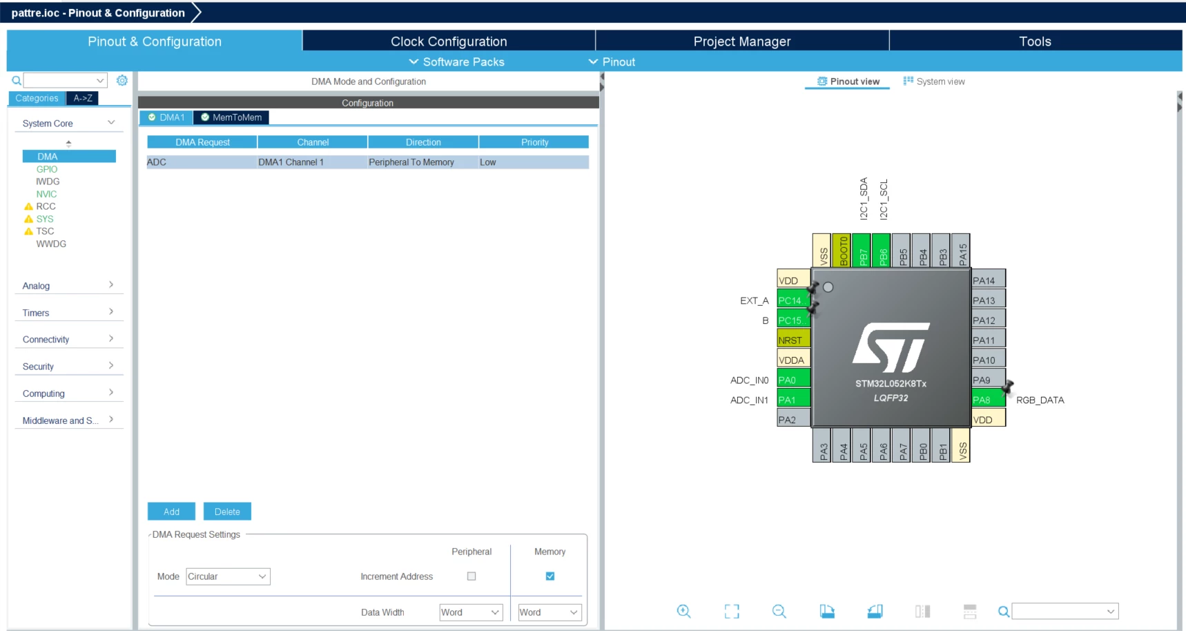

Where to call HAL_ADC_Start_DMA ?
If I call "HAL_ADC_Start_DMA();" outside of while loop, it's not working.
If I call it inside the while loop, it's working.
Issue in starting multichannel ADC through DMA

while (1) {
HAL_ADC_Start_DMA(&hadc, value, 2);

hadc.Init.DMAContinuousRequests = DISABLE;
KnarfB
KnarfBBest answer
July 24, 2024
is wrong, must be enabled.
hth

vijay_66Author
July 31, 2024
As you said to ENABLE hadc.Init.DMAContinuousRequests. I done it, but it's not working. After enabling it, lcd not printing anything

LCE
Principal III
July 24, 2024
First of all, please use the "</>" button to post your source code.
Then, what KnarfB said, and have you set the DMA to CIRCULAR? Or doesn't this STM have this DMA feature?
vijay_66Author
July 31, 2024
