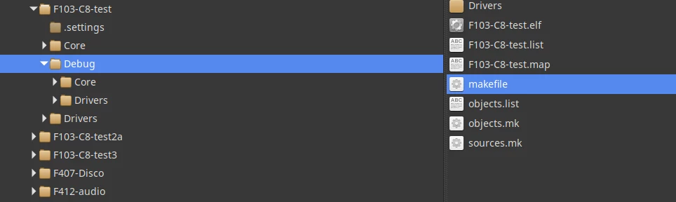

    ubaldotAuthorBest answer
    January 23, 2024
    Ok. I found them in ./Debug and ./Release, depending on how you build your project.

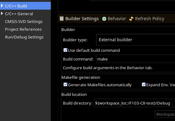

    AScha.3
    January 23, 2024
    I found this :
    and setting in project :
    seems not lying here:
