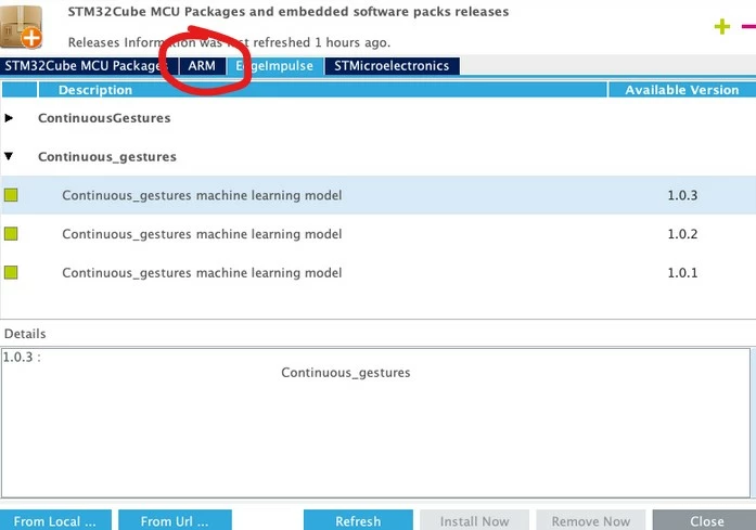

Where is the "ARM" tab in the "embedded software packs manager" gone?

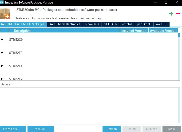

I used to manage my CMSIS install via the embedded packet manager in the CubeIDE. It was always shown, like in the second screenshot below (I pulled that one from the internet).
But now I freshly installed CubeIDE 1.9 on a new computer and the ARM tab is just not showing (first screenshot).
Do I have to change some settings to get that ARM tab back to manage my CMSIS package? Or what went wrong here?

Markus GIRDLANDBest answer
May 31, 2022
Hello there!
This was removed around 2 years ago with the release of STM32CubeMX 6.0, which was also integrated into STM32CubeIDE.
It was removed because the packs were conflicting with the files included in other packs and FWs.
You can still manually download the pack from the ARM website and import it.
