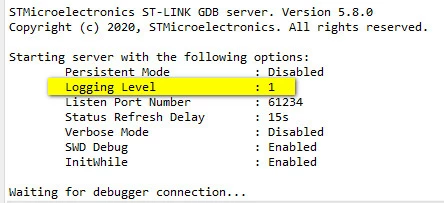

I have found that on one Cube installation is it 31 and on another it mysteriously changed to 1.
https://peter-ftp.co.uk/screenshots/20210421153074214.jpg
The change may have been triggered by me changing between STLINK V2 and STLINK V3 and trying different options to make V3 work reliably (it doesn't but I will make a separate post on that).
I have been all around the program but can't find it. Presumably it is in some script file, which is generated by the form in the attached image.

Thank you! I found the (not same) path on my PC and there is a file called config.txt. The relevant line is wholly commented out:
# -l <Log-Level>   : Logging level between 0 & 31
#     0      Disables logging
#     >=1     Enables logging of error messages
#     >=2     Adds warning messages
#     >=4     Adds communication specific messages
#     >=8     Adds all information messages
#     >=16     Adds all HW specific messages
#-l 31
so it must be using some default value. Weird how it got commented out. I changed it to 4 but it still says 31 (on this PC). So it must be using some other value. In the same directory is a batch file st link gdbserver.bat which contains

The Console output says
STMicroelectronics ST-LINK GDB server. Version 5.8.0
Copyright (c) 2020, STMicroelectronics. All rights reserved.
Starting server with the following options:
    Persistent Mode      : Disabled
    Logging Level       : 31
    Listen Port Number     : 61234
    Status Refresh Delay    : 15s
    Verbose Mode        : Enabled
    SWD Debug         : Enabled
Target connection mode: Attach
Reading ROM table for AP 0 @0xe00fffd0
Hardware watchpoint supported by the target
Failed to set com freq, status 0
COM frequency = 24000 kHz
ST-LINK Firmware version : V3J7M2B4S1
Device ID: 0x419
PC: 0x0
ST-LINK device status: RUN_MODE
ST-LINK detects target voltage = 3.28 V
ST-LINK device initialization OK
Waiting for debugger connection...
Waiting for connection on port 61234...
Waiting for connection on port 61235...
Accepted connection on port 61234...
Debugger connected
Try halt...
ST-LINK device status: HALT_MODE
Enter STM32_AppReset() function
NVIC_DFSR_REG = 0x00000008
NVIC_CFGFSR_REG = 0x00000000
Accepted connection on port 61235...
I wonder what the "Failed to set com freq, status 0" means. Anyway, this is the PC on which it is running ok.

This is the output from the PC with log level =1
    Logging Level       : 1
    Verbose Mode        : Disabled
    SWD Debug         : Enabled
    InitWhile         : Enabled
and this is the config.txt file section (btw found at
C:\ST\STM32CubeIDE_1.4.0\STM32CubeIDE\plugins\com.st.stm32cube.ide.mcu.externaltools.stlink-gdb-server.win32_1.6.0.202101291314\tools\bin )
