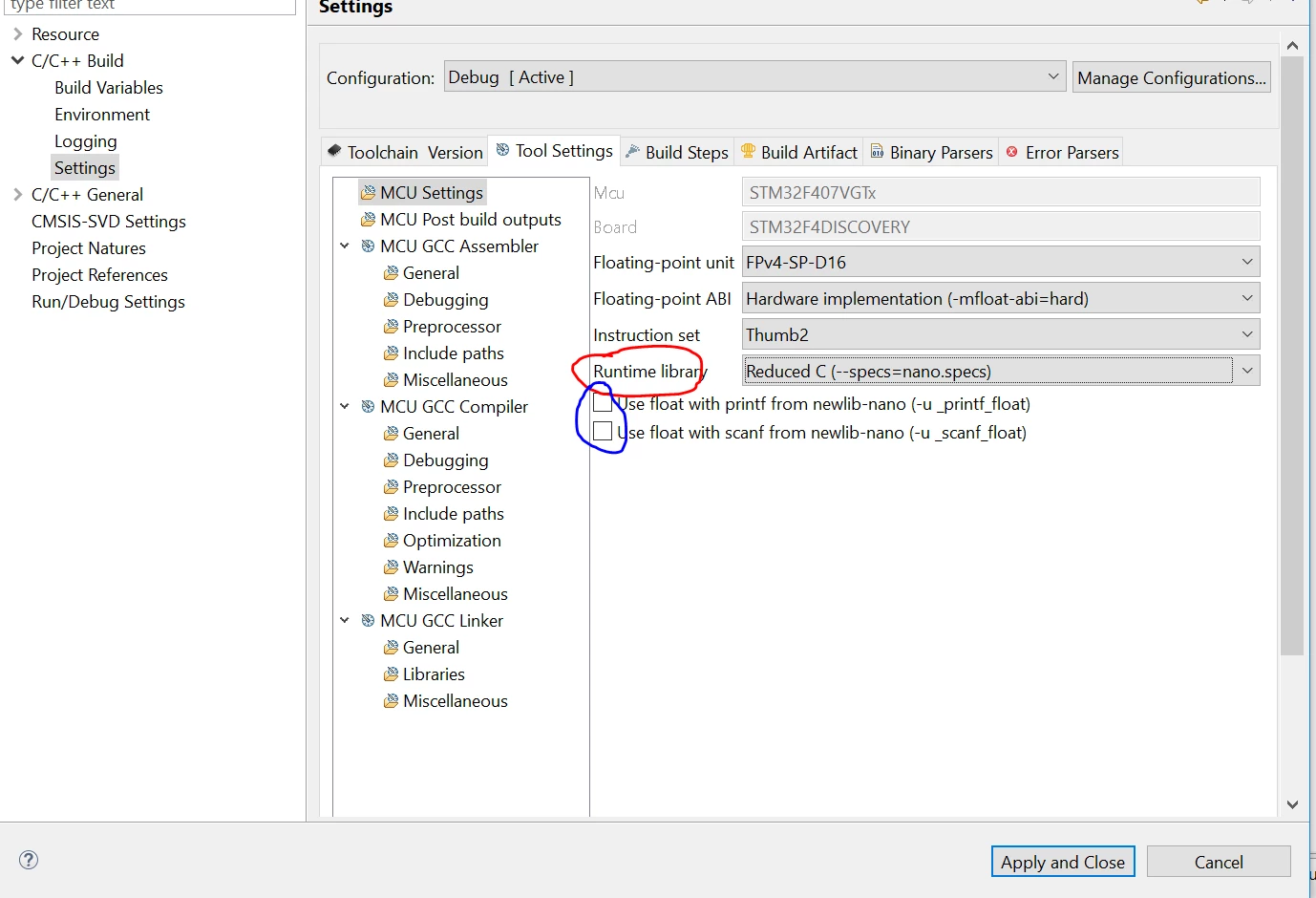

after importing my True Studio projects to the Cube IDE, I can not build my projects anymore.
I think this is because the Runtime Library newlib-nano is set as standard.
However, I have not found a way to change this to the newlib standard.
Does anyone know a possibility to change this in the STM32CubeIDE?

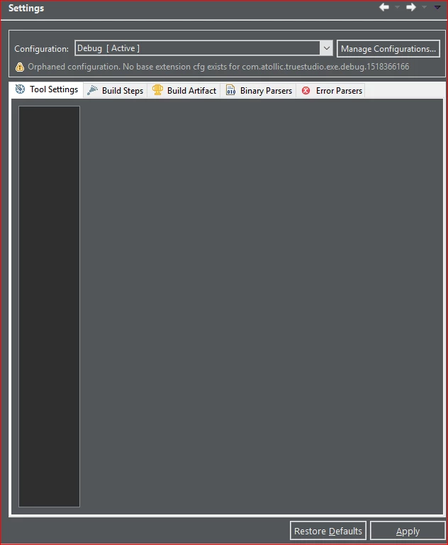

I import my projekt to STM32CubeIDE and now there is following error:
The float formatting support (-u _printf_float) is not enabled from linker flags.
Because this error i tried to use my old version (True Studio 9.2.0).
But now the project is damaged (see attachment)
I hope STM will fix it fast.

@Knut_Knusper​ The runtime library is changed inside Project Properties -> C/C++ Build -> Settings -> Tool Settings, the red circle in the picture below.
@mfrank9​  Same place as mentioned above but the blue circles.
The project might have been damaged because it doesn't look like it was properly imported. Please follow the instructions in the import manual, UM2578.

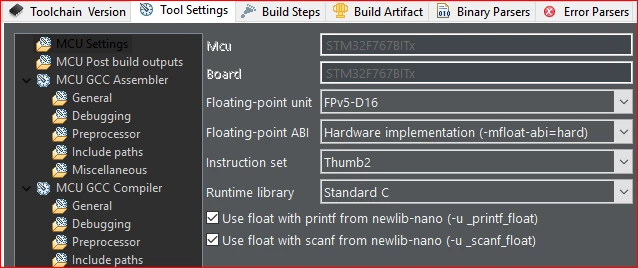

Now if have the following Error:
"The float formatting support (-u _printf_float) is not enabled from linker flags"
This are my settings:

@mfrank9​ I think it could be an error from the Code Analysis (Window -> Preferneces -> C/C++ -> Code Analysis ).
Because in my project I have the same error in the Tab "Problems" but the build finished without errors.
There is a new option called STM32CubeIDE CodeCheckers: Float formatting support.
In Atollic was no option with this name.
Maybe the Code Analyzes has an Bug and it does not recognize that the flag has been set.
