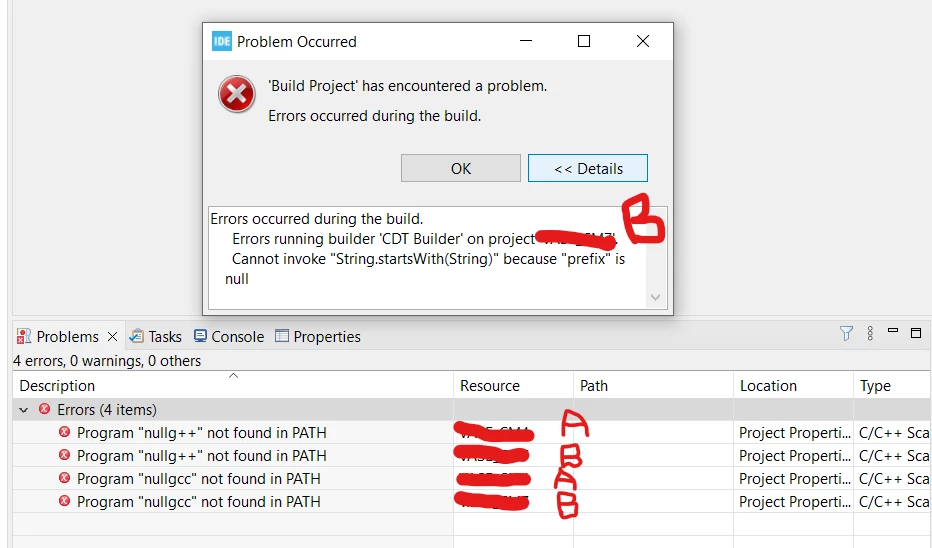

Hello All,
I have searched the forums and cant find something that can help me solve this, so I am coming out of the shadows for some assistance.
I am completely new to STM32CubeIDE and I am attempting to build a project, using a different toolchain than what is the default.
When I attempt to build the project using the default toolchain "GNU Tools for STM32 (12.3.rel1)", the project builds just fine. However due to a problem with that toolchain on the project, I am required to use a different toolchain.
When installing and using a different toolchain (I have tried multiple and have gotten the same following issue), I get the following error:
Can anyone help, or maybe even point a poor noobie in the direction of an answer for this issue?
Thank you!

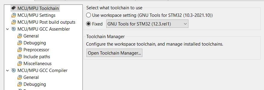

The CubeIDE user guide has something about using alternative toolchains. Have you read it?
Dec 30, 2024 6:59 PM UTC
I have read section 2.3.1.1 of the UM2609, and followed that in order to install and use the different toolchains.

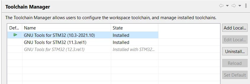

Dec 30, 2024 7:50 PM UTC
The default toolchain that I used that *is* capable of completing a build is GNU Tools for STM32 (12.3.rel1)
And the two that I have tried that are *not* capable of completing a build are as follows:
I apologize for my lack of understanding, but what do you mean by "similar layout (subdirectories)"? I am not sure where to look to answer that question.

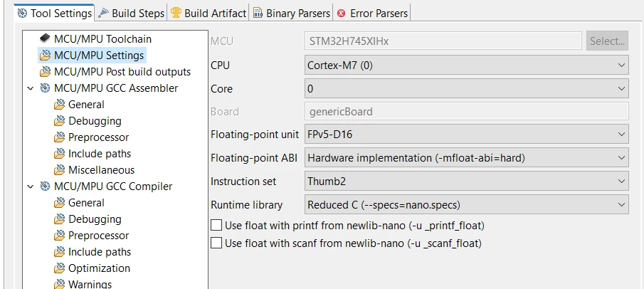

Interestingly though I have noticed one seemingly major difference when selecting different toolchains.
When selecting the default and functioning toolchain, 12.3.rel1, in the MCU/MPU Settings, all of the available dropdowns are filled with selections:

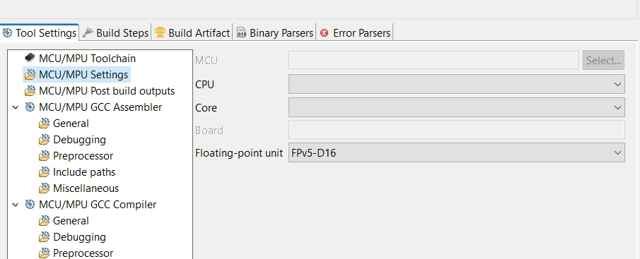

However, when selecting a different Toolchain, say 10.3-2021.10, all of those dropdowns are empty, and it also is missing dropdowns:

Dec 30, 2024 11:00 PM UTC
Okay, well, I reinstalled the program and updated, and now everything is working hunky dory. Thank you for taking the time to respond Pavel.
I am not sure how to mark this topic closed.
