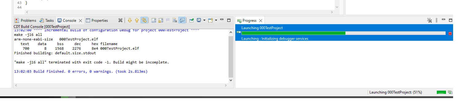

When I try to launch my debugger I see it gets stuck at "Initializing debugger services"
The IDE is stuck at "Initializing debugging services" during debugging
4 replies
Markus GIRDLAND
June 22, 2022
Hello there,
I would try a few things first, if nothing helps we can try to troubleshoot it further:
  • Right click the project in the project explorer and select "Index -> Rebuild"
  • Make a clean build by right clicking the project and select "Clean Project"
    • Then build the project again
  • If none of the two steps above helps, try making a new workspace and import the project to the new workspace and see if anything changes
Let me know if any of the steps above helps or not!
