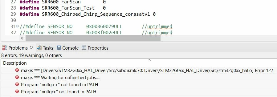

When I inported the project created in different PC and worked there, the error "program nullgcc not found in PATH" occurs on my PC and cannot build it. How can I fix this problem?
I also saw the similar problem "arm-none-eabi-gcc not found in PATH". I fixed this by changing the plugin path, but for nullgcc I'm not sure which path needs to be changed. I already changed some suspicious pathes. I may not have the program.

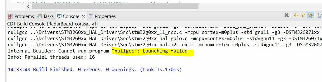

I attached the build result with make exist.exe in specified path, but nullgcc error exists. Is this acceptable?
But when I use other version, error " make not found in PATH" also appears. Even after I changed the path's name of "com.st.stm32cube.ide.mcu.externaltools.make.win32_xxxxx" to match as above, the build looks failed.
