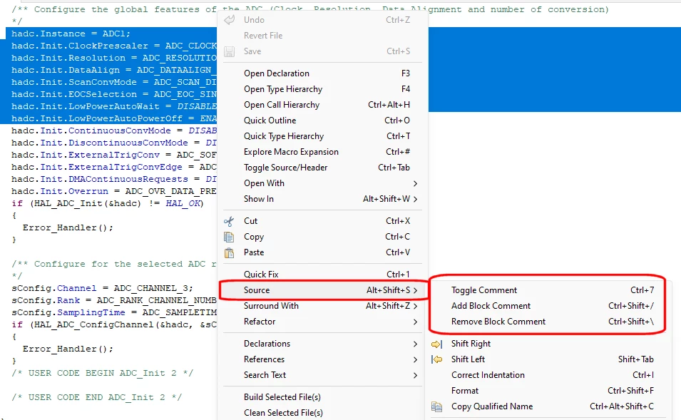

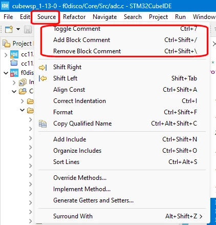

Thank you, is there an opportunity to look a full list of hotkeys in CubeIDE?
Andrew Neil
June 17, 2024
The hotkeys are shown in the menus:
Also available on right-click:
