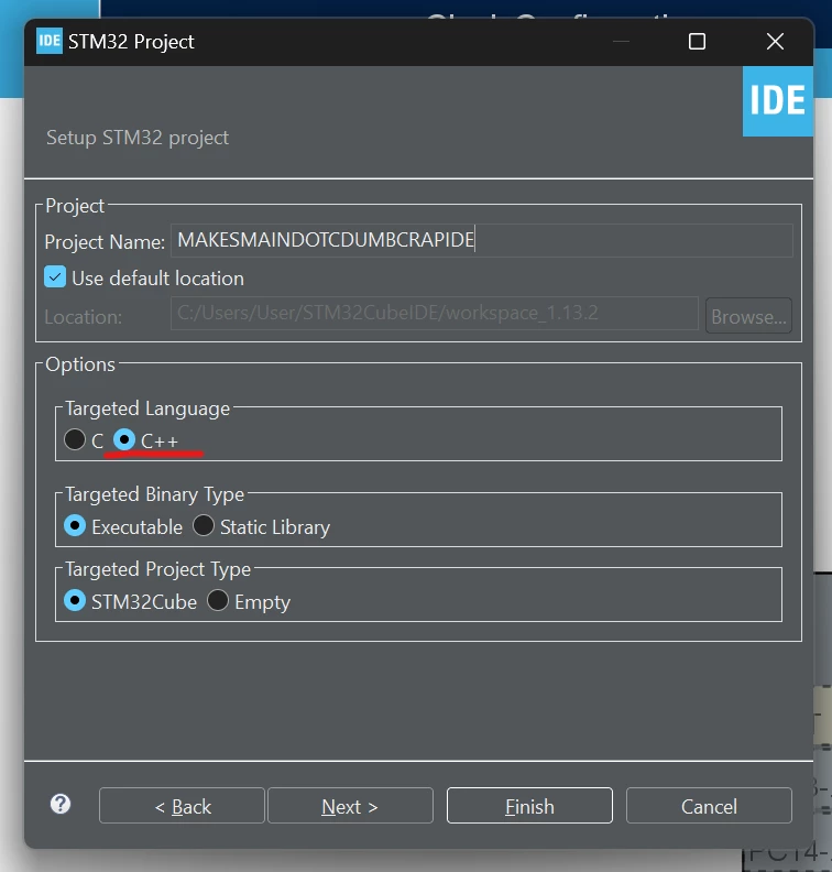

What is the point of this UI element?
    2 replies
    I realize this post is more a rant than a question seeking a solution, but the point of the element is to include the C++ compiler in the project. Files still need to be named appropriately for it to be treated as a C++ file. If that's not checked, and you have *.cpp files in your project, it won't know what to do with them.
    Semer CHERNI
    Hello @capnhyaku
    The STM32CubeMX (the code generator) does not generate C++ code it only generate C code.
    However, like @TDK  have mentioned, the this check box is used to include C++ compiler in the project in case your project will contain C++ code.
    For example, if you are planning to use TouchGFX for graphics you need to check this box as TouchGFX will generate C++ code.
