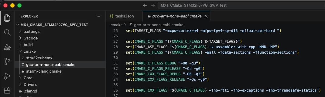

To reply on your more specific questions:
  1. - Switching active configuration (Debug or Release)
  2. - Flashing the target MCU.
  3. - Debugging via line-by-line walkthroughs.
  4. - Set debug levels and optimisations.
  5. - Set hardware or software floating points.
  6. - Output .bin firmware
Let’s try to answer on-by-one…

  • Debugging via line-by-line walkthroughs.
    • I don’t understand the question… Both C-line and assembler instruction stepping is possible!
  • Set debug levels and optimisations.
gcc-arm-none-eabi.cmake line 31-34 in this case...
We do not have “build GUI” on top of CMake because CMake is a language of its own and building a GUI on top of it would quickly turn into a problematic mess. instead let CoPilot help you modify build settings!
  • Set hardware or software floating points.
Look at screenshot above, line 25. Does that help you?

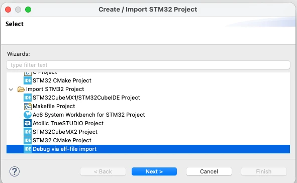

Let me shine some lights on some of your questions. We will continue to develop/maintain both CubeIDEs (Eclipse and VS Code). The Eclipse version will continue to support new STM32 MCUs. In VS Code we will ouf course support all MCUs, but we will also put extra focus on trying to close the gap on debug features.
Some thoughts/recommendations if you want to move from Eclipse to VS Code:
  • Which IDE to use? Use the one you feel give you the best efficiency!
  • If you want to move to VS Code there is now a “project converter” from Eclipse to CMake:
project converter
  • If you are missing any debug feature from CubeIDE/Eclipse, then keep CubeIDE/Eclipse as a stand-alone debugger.
  • This dual-use means you use CubeIDE for VS Code and CMake for Edit, Compile and simple debug.
    And CubeIDE/Eclipse for advanced debug.
These recommendations should minimize your porting work (some manual steps may be needed) and if you need advanced debug features you are not stuck waiting for us to add these featues in VS Code. Have a try if you want!
